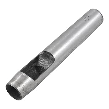

Couple questions (not another question from Crabby, doesn't he ask a lot of questions...). When you "drilled" through the carpet, did the bit tear up the material at all? I think I read somewhere that you reverse the direction of the bit to get through the carpet and then tape the bit to prevent it grabbing the material when drilling into the metal. May have been mistaken or asleep, I can't remember. Second, did you put any sealant/gasket between the washer and metal of the van to prevent moister getting in?
For some holes, I put a gasket punch in my cordless drill and it cut through the carpet perfectly. However, most of the holes we used an awl and just poked through (be careful not to poke through other stuff under the floor). The gasket punch trick works great if you have access and you know where you want the hole.
