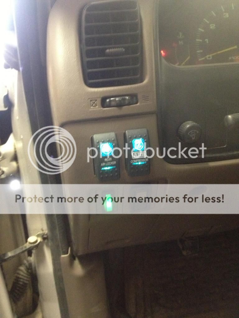

I got the ARB rear locker wired up and functioning on Friday. I moved the "Clutch Start Cancel" button down next to the driving light switch and mounted the compressor and locker switches next to each other. I moved a couple thing around a little under the hood and was able to squeak the small ARB compressor in next to the Airbox.

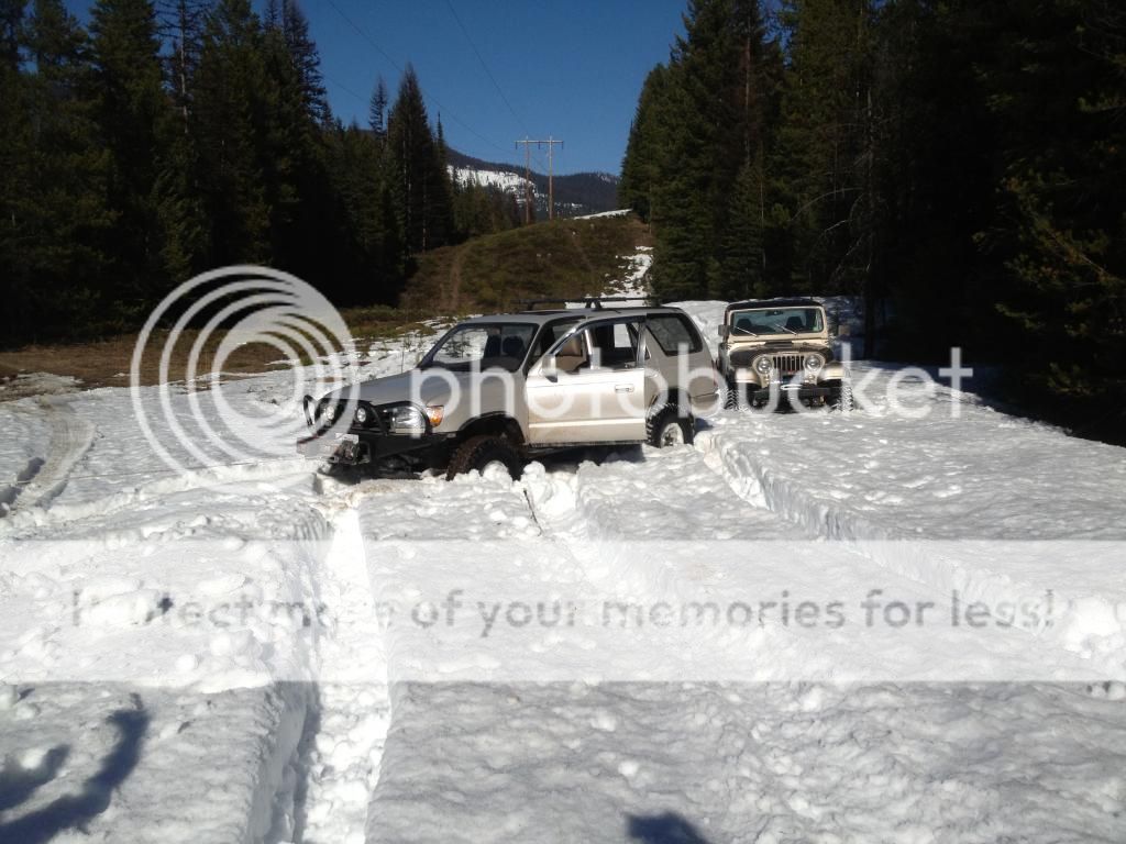

I really wanted to get off road in the 4runner and some friends were going out playing in the snow on Sunday. I decided to take my Tacoma and am glad I did, it was still really deep in a lot of places. I'll use that rear locker in the 4runner soon though.
