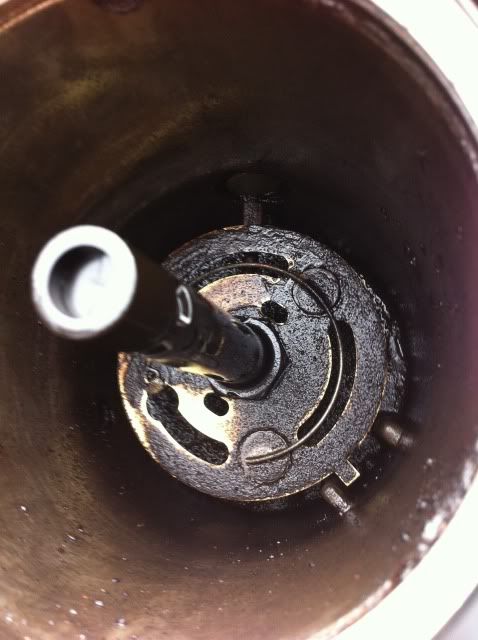

I have been having a few issues with idling and running when I come to a stop (very randomly). So I decided to start troubleshooting it. First step was to change the fuel filter.

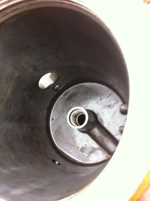

Pulled it I did not think it was too bad, so looked into the fuel bowl.
Yeah it was dirty, so I dug in and pulled the entire fuel bowl.

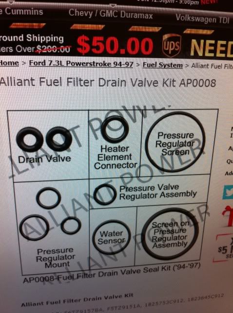

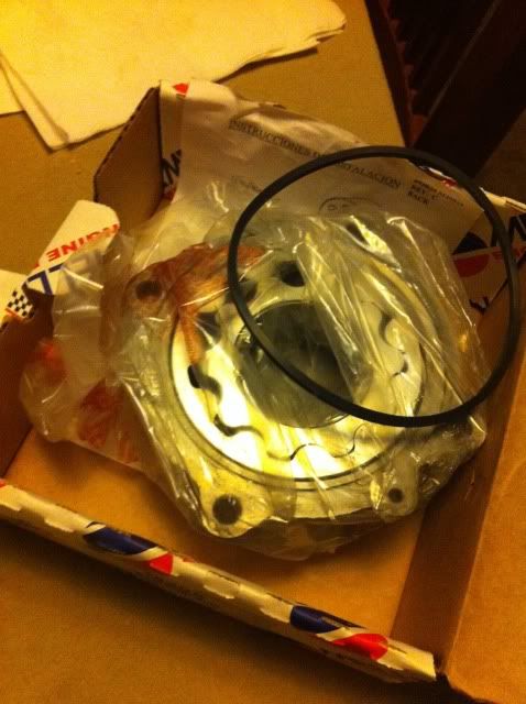

Rebuild kit:
Cleaned:
Then reasembled. The fuel pressure regulator screen was almost completely clogged, total of probably a teaspoon of crap in the bottom of the bowl.

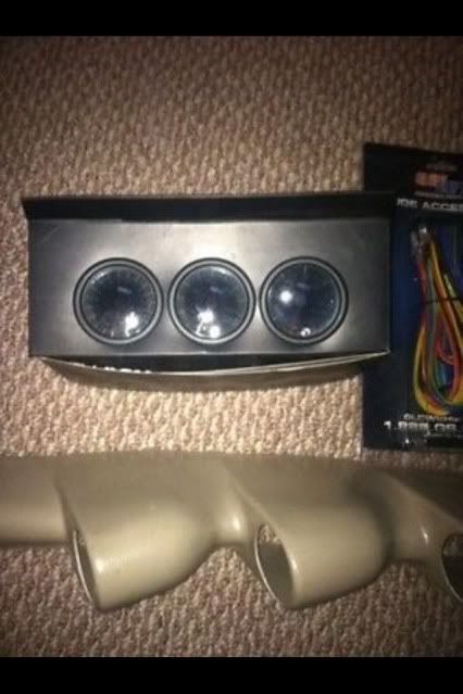

I bought some gauges a few weeks back but forgot to post up about them.
Glowshift 7 color - EGT, Boost, and Trans. temp. It came with a F series 3 pod pillar. I need to sell the pillar pod and buy a E-series 3 hole gauge pillar. Cheapest I have found shipped on the e-series is Summit or eBay, if anyone has seen them cheaper than $73 shipped let me know. Also If you or someone you know needs a Tan F-series pod let me know.

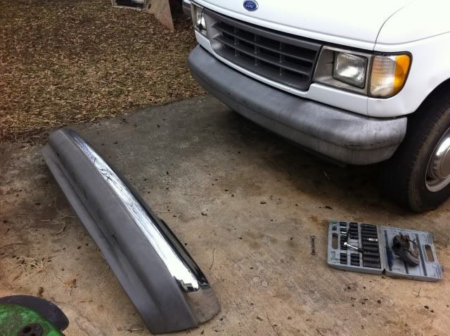

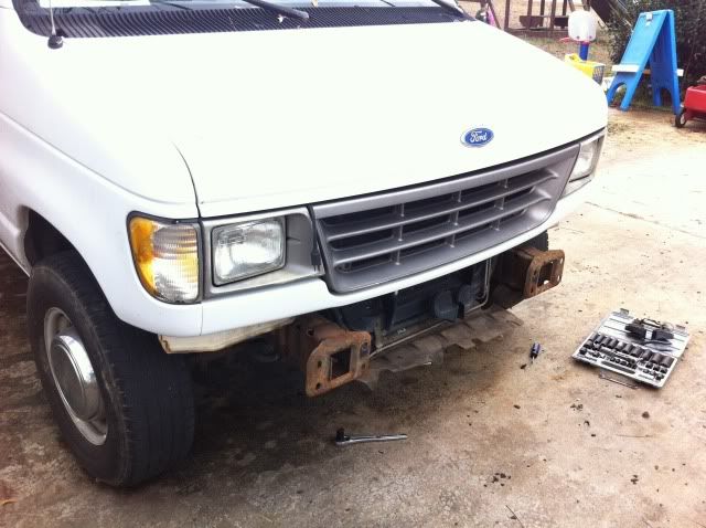

Front and rear bumpers pulled and swapped, Pulled rear hitch, bolt holes did not line up when I tried to swap. Maybe E150-E350 are different?

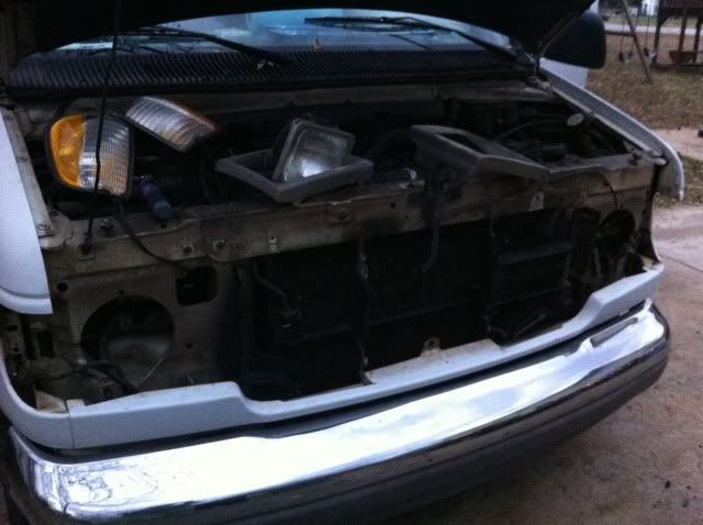

Headlight panels pulled (Switching from sealed beam to composite beam).
Height difference is not exact with this pic since the driveway is a few inches higher, but its obvious in getting in/out, especially in the rear

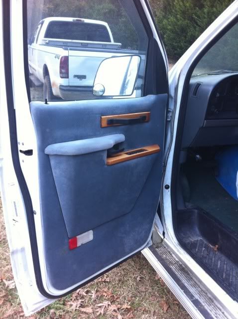

Swapped in the rear floor trim as I didn't have anything back there. My door areas are a little damaged, not sure what I will do there. I do have the parts van so I guess I could cut what I need to fix out and weld it into mine?

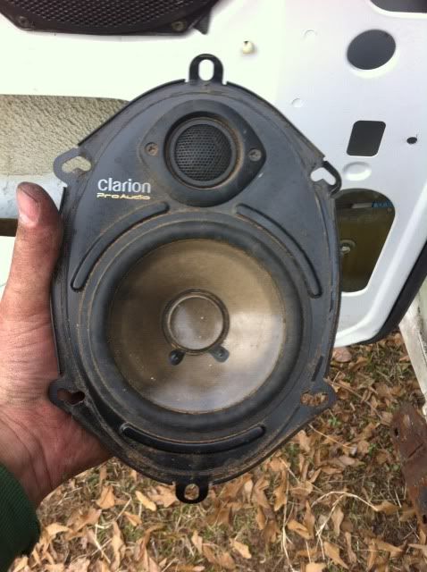

Pulled rear doorpanels, trim and swapped aftermarket speakers (testing fitment). I need to paint the faded plastic window trim at some point and also insulate so I went ahead and pulled everything. I wanted to swap out the rear doors but I figured it would be helpful to have help before I tackled them.
This these are shot?
Not perfect, but I pulled these out of a car at pull a part a few years back. Hoping they will sound decent.
