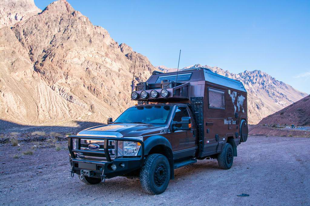

I just got back (June 2017) from a 2 + year trip in South America with my 18,000 pound Ford 550 GXV. The trip was wonderful despite the Kelderman / Accuair suspension system. I was baffled that Earthroamer and GXV would use a critical suspension system with..... how many critical failure points ?? (computer, sensor arms, compressor, fittings, solenoids, air lines, wiring, air bags.....) ALL of which failed (multiple times) except for the compressor and airlines. I think the answer is two fold... the designers, living in the US with instant access to parts and competent service, can't get their heads around the concept that you are completely alone with no possibility of getting parts without flying back to a 1st world country, purchasing the parts and then fly back. Second, I don't think there is really a good alternative to air suspension when you get up to the loads of large overlander vehicles. In addition, I don't think many of these rigs are actually driven in the 3rd world for extended trips. I base this on a tour of the Earthroamer factory (June 2017) ..... was told that out of all the Earthroamers built, not one vehicle was known to be traveling in South America.
My solution... I am having the suspension completely rebuilt with Kelderman airbags but with no electronics, no feedback level control loop for automatic leveling, no computer... no crap that looks flashy in the show room but breaks in the middle of some sketchy road in Brazil. The airlines go to directly to pressure gages mounted in the dash with a manual switch to put air into and out of each bag. I have one integrated unit which houses the solenoids, air compressor and tank. I will carry a spare and rebuild kits. If anyone is interested I can explain the unit more with pictures when I get it back from the shop in a couple of weeks.

Thanks for sharing!! A little OT, but can you share the wheel and tires your running as well? I too would like to hear more about the failures.
And a pic of your truck FWIW
