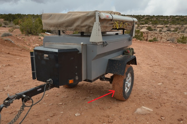

I used to run tires with more of a street tread on my trailer as I was only considering the minimizing of on-highway rolling resistance. After running the trailer for almost 7 years I can say that traction is a factor and I did have situations with sideways slippage on those original tires.
This set of shots is from an area in Moab near the White Rim Trail after the snow melted
The street tread tires became big slick donuts with no real traction and I saw the trailer slipping left and right behind me on the muddy trail as I went uphill and around corners.
Now I run Duratrac tires on the trailer and have not seen the tires become coated in mud that could not be flung off with modest speed. I have found that having a good self-cleaning tread is as important on the trailer as it is on the truck. Having the same tires as the tow vehicle also gives you more spares for the tow vehicle in an emergency.
I cannot say with certainty the weight of my trailer when loaded but it is heavy. I do have both springs and shocks in the suspension but even then on highway I run 32 psi and off-road I will drop it to 25 psi so the tires will more easily conform to rough trails and present less resistance for the tow vehicle to overcome.
