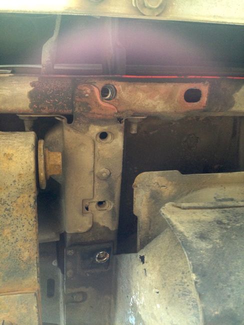

So I got some more wrenching time in on the Jeep today. Two weeks ago I found a Reese Tow-power class 3 hitch on sale cheap online and jumped on it. It got here thursday but wasnt able to work on it until today.
Now I know most wont be interested in reading about a hitch install, but I know there are people out there that search for stuff like this. (I know I have been there before) Also, some hitches dont come with instructions or they are very vague.
The hitch has multiple mount options based on if you have a 96- or 97+:
-factory gas tank skid (has passenger nut strip)
-factory rear tow hook (has drivers nut strip)
-or a model without either of the above (will need to use the supplied hardware or buy OEM/aftermarket nut strips)
Fortunately my XJ has both so I have the nut strips on both sides. If you dont have either or just one, you will have to fish the supplied carriage bolts and plates through the rear of the "frame rail." It sounds tedious, but with the supplied "fishing" wire, its rather easy.

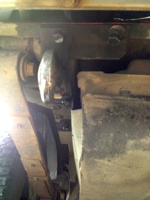

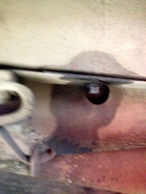

This is the factory tow hook. You have to remove the 3 bolts holding the bracket/hook on or else you cannot install the hitch

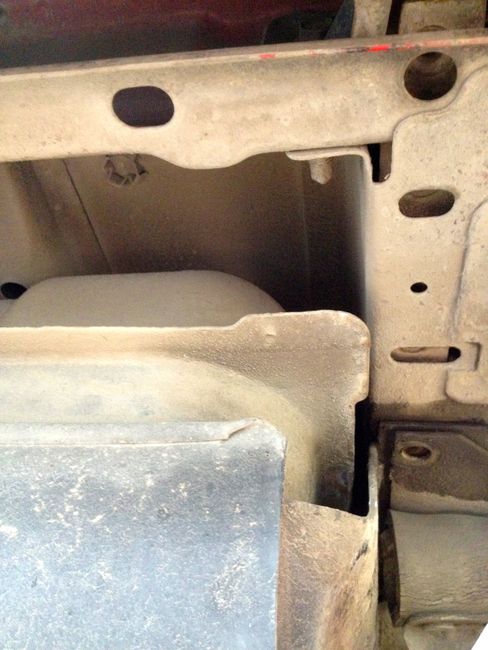

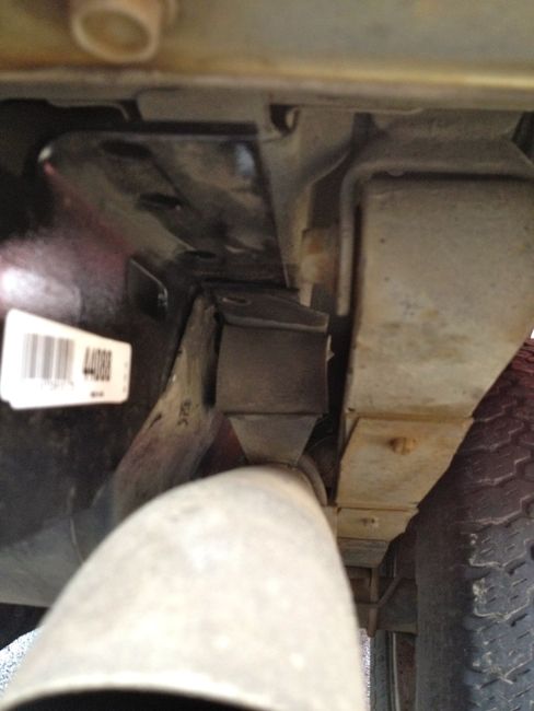

You need to remove the two rear gas tank skid bolts as well as loosen the front two to where about 1/4in gap is showing between it and the "frame rail"
Now the hitch will need to be slid in up above the gas tank skid to where it is sandwiched between the skid and the "frame rail"

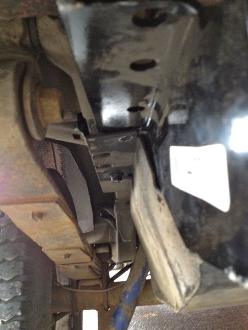

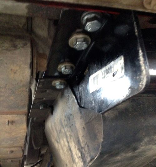

Then its just a matter of lining it all up and installing the bolts
The final step (on a 96-) is to remove the front gas tank skid bolts and insert the supplied washers as spacers and reinstall the factory bolts. Then torque all hardware down to spec

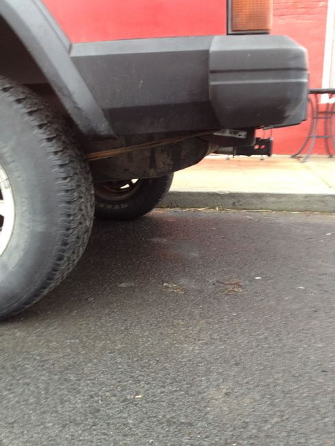

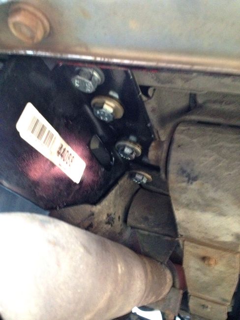

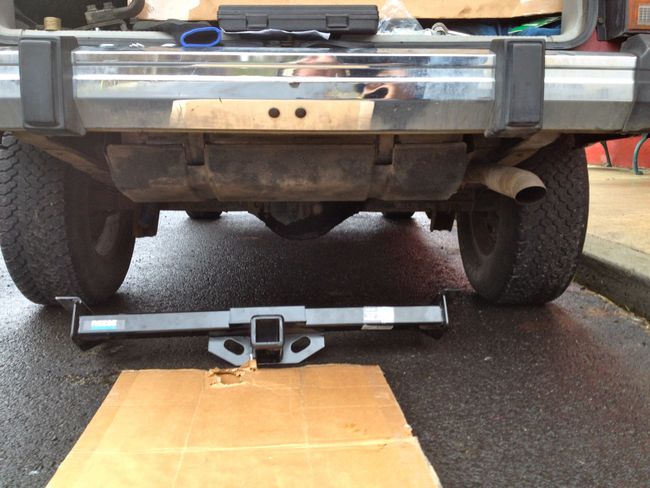

Here is a before and after. For those who say hitches affect ground clearance, that may very well be true but I believe this Reese model does not.
After all is said and done, I am very happy with how it went and how it looks. The nut strips made it SO much simpler. The only thing that took awhile is having to drive 40 min total in to town to get a 18mm socket.
[Side note: I hate that most major brands don't include them in their socket sets as well as wrench sets. Oh well, I have them now :lol: ]
Once that was done some WD-40 and my 17" breaker bar made quick work of it. :boxing:

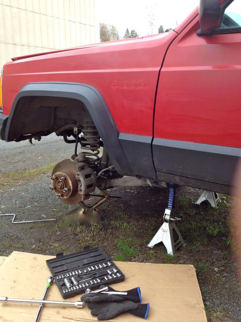

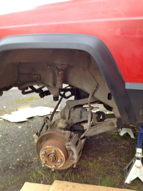

Here it is all set up and ready to start (dont judge my scissor jack)

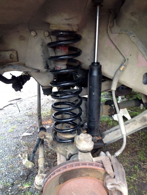

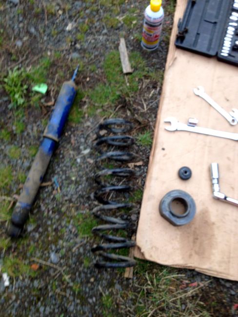

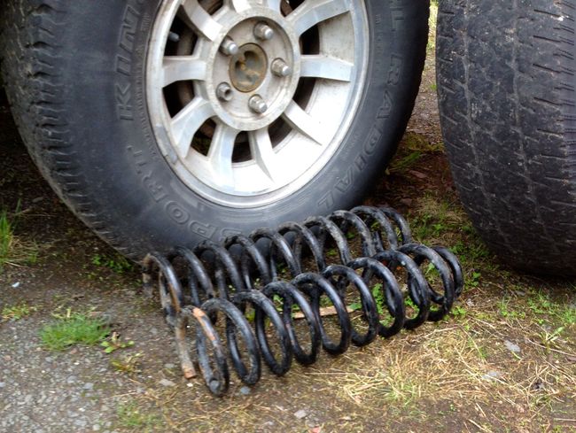

Here are the Zone 3" coils waiting to go in
I just unbolted the top sway bar bolt, unbolted the bottom of the shock, and let the axle fully drop down. I then used a jack on the opposite side to force the axle down.
Out with the old.....
.....and in with the new! Looks like I need to order some new bumpstops. They are missing from both sides. :Wow1:

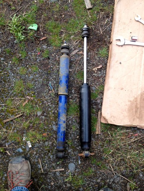

Here is the difference between shocks. Im not sure if the old ones were factory or not. Its hard to tell since there isnt really rust on this thing. :)
Now I know there may have been some "easier" ways to do this: floor jack, unbolting control arms/track bar, and coil spring compressors etc
...but honestly, I live in a little town 45 minutes (round trip) away from any auto parts store and I just wanted to get this done. If I was installing a taller coil or a spacer with the current one I would have DEFINITELY used one or more of the above options. But everything I read before hand said it should be easy since it was considered "less than 3 inches total" and it turns out, it was!:D
