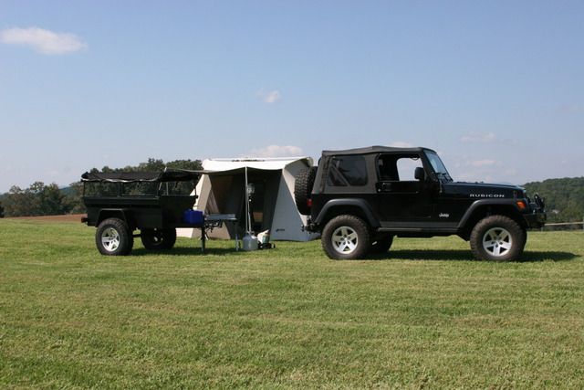

I tow an m416 loaded down with camping gear and rtt about once a month. I have yet to weigh it, but My TJ alone weighs in at 4200. I have 35" tires and 4.88 gears but it pulls the trailer at the posted speed limit just fine unless I'm climbing some of the stupid steep mountain passes in NC and TN.
