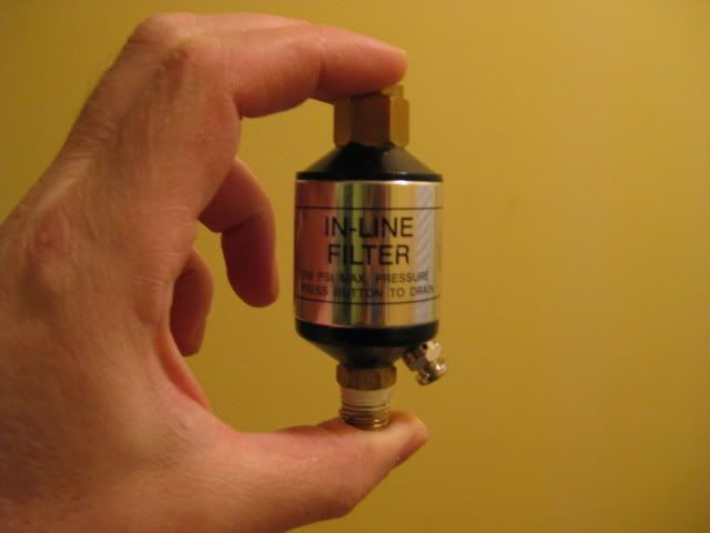

One thing I wonder about the LP air moisture separator is (never having taken one apart) do they need XXpsi acting upon them?
Perhaps something with a desiccant that's changed out every six months.
The moisture separator is free flow and no they don't need a certain psi to work.
I've noticed condensation in the cap/bed. It's not leaky, it's due more to our climate. Ontario can get humid year round.
I also hose the rear out from time to time. If the inside isn't totally dry I get condensation. When I wash the back of the truck out, I'll bag the air filter end so it doesn't get wet. Any condensation will hopfully be filtered out by the separator.
I was looking for air line fittings in my shop. for the breather hose.
The separator was kicking around without any future use, and I got creative... LOL
Bling eh? :p
When I blew into the end of the separator, to see how 'free flow' the devise actually is. After testing it, I noticed condensation on the inside. I was pleasantly surprised, it may work after all.
Anyway, the separator was free flow without effort.
I'll keep a curious eye on it to see if it works.
Honestly, you don't need a separator. A free flow or stock breather at the end of the breather hose, is all you really need. It would be pointless if you live in dry parts of North America.
When I removed the stock breather it was nasty! A good build up of grime, dirt caked in oily goo plugged up the stock breather, on the axle.
Snow, ice buildup, salty road sludge, mud made the breather useless. I couldn't even use the stock breather at the end of the breather extension tube it was so plugged up. I couldn't even blow compressed air through it. :Wow1:
My new breather...
If you want additional filtration above and beyond the filter end I used or the OEM, you can use a in line free follow air filter. The release valve pictured requires pressure to work, the diffs air flow is far from volume.
The minimal air flow through the breather tube, this type of filter ( as a secondary filter) would not need replacing if it's located in a sheltered location.
This filter is cheap to buy. I payed $5. It may be worth it for those wheeling in the desert.
