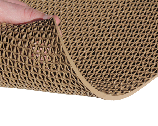

This Z Web No slip Drainage Mat would be perfect.

Youll want a mat like the one above and a slight gap in the trailer lid. If I recall correctly the basecamp we tested had a lip on the lid. you should be able to stick two thin pieces of rubber on the passenger side of your trailer to just SLIGHTLY crack the top during storage. This will let air flow go back and forth preventing a lot of your issue. Like others have said though, you still may need the mat. You have cool air under the trailer it just happens.

That z web mat looks just like what CVT sells for anti-condensation under the mattresses for their RTTs. I have it in green.

You may have a leak, but don't discount a proper mat. The anti condensation mats they Tepui and CVT sell are weaved in such a way to allow horizontal air flow, not just vertical.
Last week I camped with my boys. We're in a roof top tent on a dry but cool night with all the windows open all night. Unbeknownst to me the anti condensation mat had slipped out from under 1/3 the mattress when deploying. The next morning when closing up I noticed moisture under the mattress. Where the pad had slipped away it was quite wet. Where it stayed put it was as dry as a bone.
