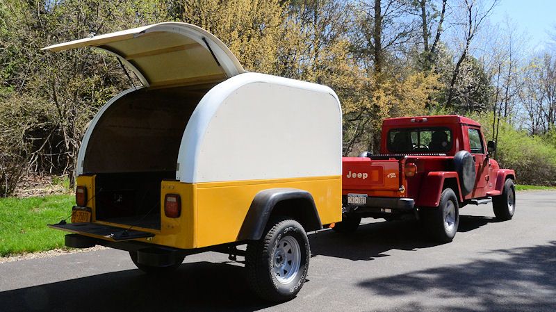

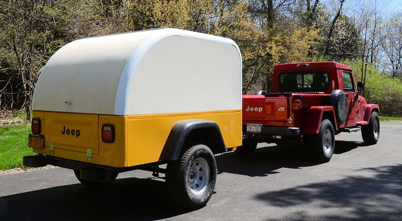

A few photos of the proof of concept:
AssemblyDone2_zps68510075.jpg~original
AssemblyDone3_zps92834b7f.jpg~original
Any of the TrailTop molds or the teardrop proof of concept are free to anyone who wants them. Too much trouble to ship though, so they'd have to be picked up.
