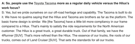

I really don't know why Toyota insists on it. When asked Mike Swears, who was at the time the chief engineer on Tacoma and Tundra, is the source for what I said. But even he is talking around it because he mentioned the 4Runner being more refined and it's got a fully boxed frame. So to your point (on which I agree completely), I think the modern design philosophy is to make the chassis as rigid as possible and tune the ride by suspension. People who are familiar with Hilux immediately notice it "rides like a truck." I wish my Tacoma did more.

I thought the reason the 4Runner and 200 series are fully boxed while the Tacoma and Tundra were not had to do with the 5 link suspension vs leafs. Sweers specifically stated that was why the 3rd gen frame went fully boxed.
Additionally, the 4runner and LC had a continuous body that is not going to want to cope with as much flex as a truck with a totally separated bed.
