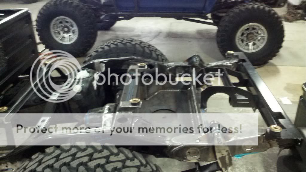

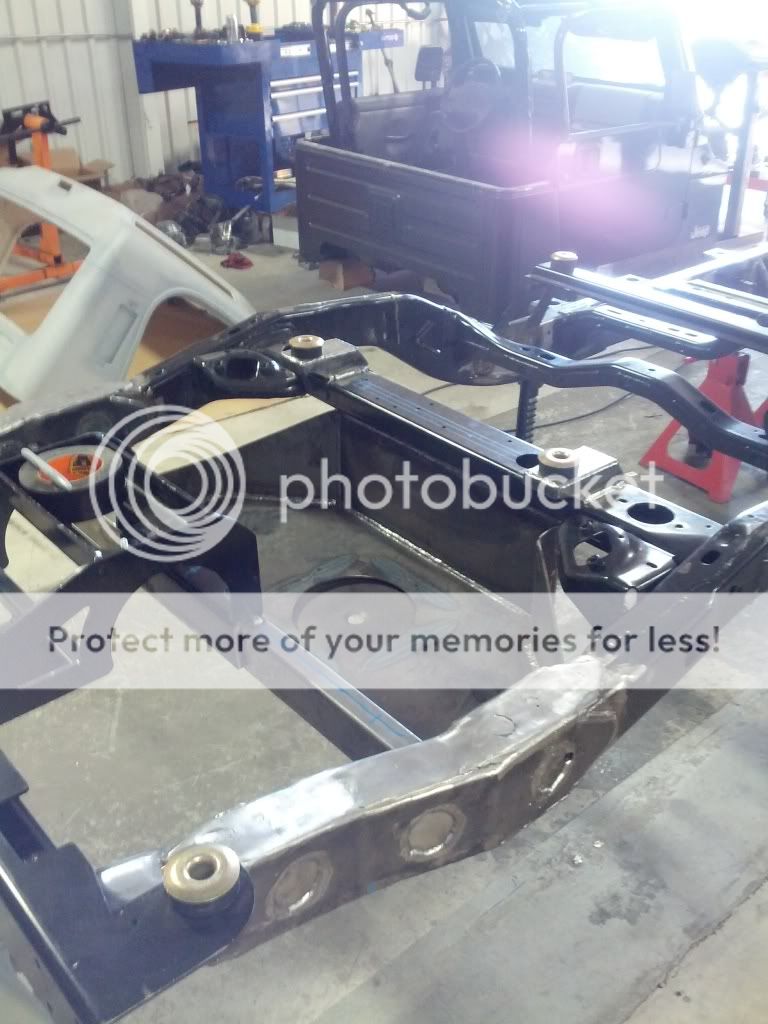

I've played with fitting both the JK and the JKU tanks in a JKU frame in addition to a TJ rear mounted tank. While my application is a little different you can make them fit. You cannot use a second JK tank on the drivers side as was mentioned though. They are molded around the crossmember.
But that begs the question why you really NEED almost 70 gallons of fuel in a JK....
two door vs 4 door
and arrangement of both tanks keeping in mind the rear half of my frame has been um... adjusted :)
The stock crossmember is still there though and that would be the JK locating point. Excuse the blurry photos.
Septu
^^^ Maybe I'm missing something... but where was the 2nd tank in those photos? I saw what I assumed was the skid plate for one at the rear (like the Genright tank), but no tank.
