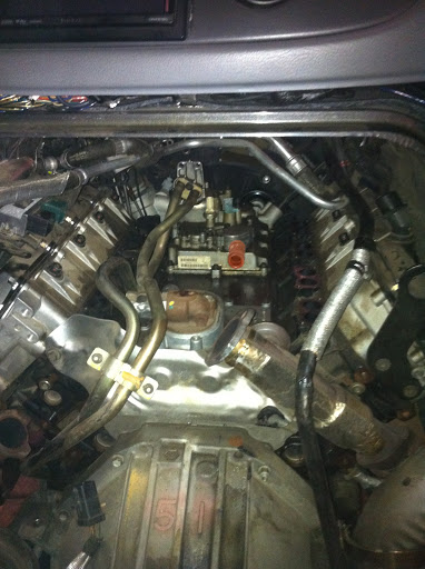

Here's a shot of the EGT sensor. Hopefully it's clear enough. I drilled & tapped the drivers side manifold. For the cooler, I'm welding the exhaust port up, and blocking the inlet to the intake. Coolant will still circulate thru the cooler. I had my turbo rebuilt last night, there was enough carbon buildup to freeze up the ring. Can't wait to see how good it runs when I'm done!
And here's what a 6.0 looks like with everything removed from the intake up!
