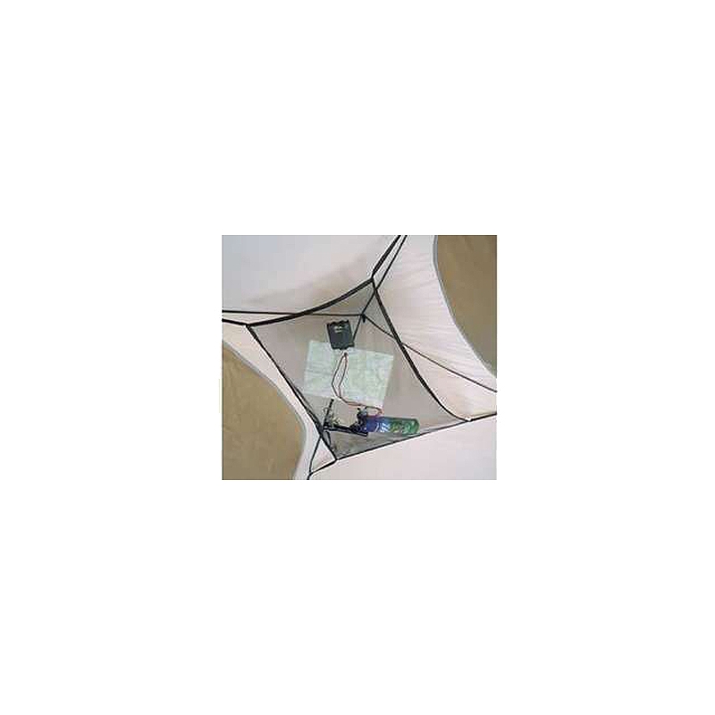

I was further inspired by this one from You, Me & The Parks from this post: https://www.youmeandtheparks.com/posts/ursa-minor-j30-buyers-guide who use an 'REI Topper Net' for their storage needs. I think it may be this: https://www.rei.com/product/829841/msr-universal-gear-loft which is currently out of stock.
I loved this idea, however I wanted a larger solution that uses more of the ceiling real estate so that I can keep all of my necessities within reach above my head when sleeping. I've used similar solutions in the past when tent camping and I know how valuable it can be to know where exactly your stuff is when you open your eyes without having to scramble around for it in the bed. I found the Big Agnes Gear Loft Tent Accessory, Wall: https://amzn.to/3HH38Ky
