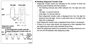

Got a hard start, rough idle, no rev condition which turned into a no-start condition. I'm figuring a fuel delivery problem of some kind. The flash code I read code 112. A single flash, another flash, brief pause then two quick flashes. I'm only seeing two digit flash codes, not three. And an 11 code makes sense, indicating a problem in the electronic governor which is where I figured the problem was likely to be. Anybody have any idea what the quick double flash meant, the '2'?
glennm01
The pic below is from the 2002-2004 shop guide, and if I'm reading it right, the interval between flashes is different for the tens column (1.2 seconds) vs. the units (0.4 seconds). Given your description of your flashes, it sounds like your error code could actually be a 22. Unfortunately, the 02-04 shop guide only shows a 21 and 23 code, but no 22. Maybe the older models have a 22 though? And of course, this is all assuming the intervals for the older models remain the same. Anyway, just thought I'd pass this info along in case it helps.
kerry
I think you're probably right, it's a 22. If it is a 22, it's similar to the 11 code according to the list I have. CRS too low for 22. and CRS Pressure SNSR either high, low, or plausibility for 11. I think CRS pressure must refer to fuel pressure which means my initial hypothesis of inadequate fuel flow is likely correct.
kerry
I don't know but I assume the only thing which could be low is fuel pressure since boost pressure codes say 'boost pressure'.
kerry
I just looked at the table I have and the flash code interpretation is for the later 4m50 engine and not for the 4d34t I have. So I'm not sure what exactly the 22 code means on mine. Does anyone have a flash code interpretation table for the 99-2004 US model Fuso FG? The table linked very early in this thread is no longer available at that url. edit--looking earlier in this thread I read that Gait said 22 was control rack position sensor. That would correlated to my hypothesis that the linear actuator in the electronic governor is sticking or not working properly.
