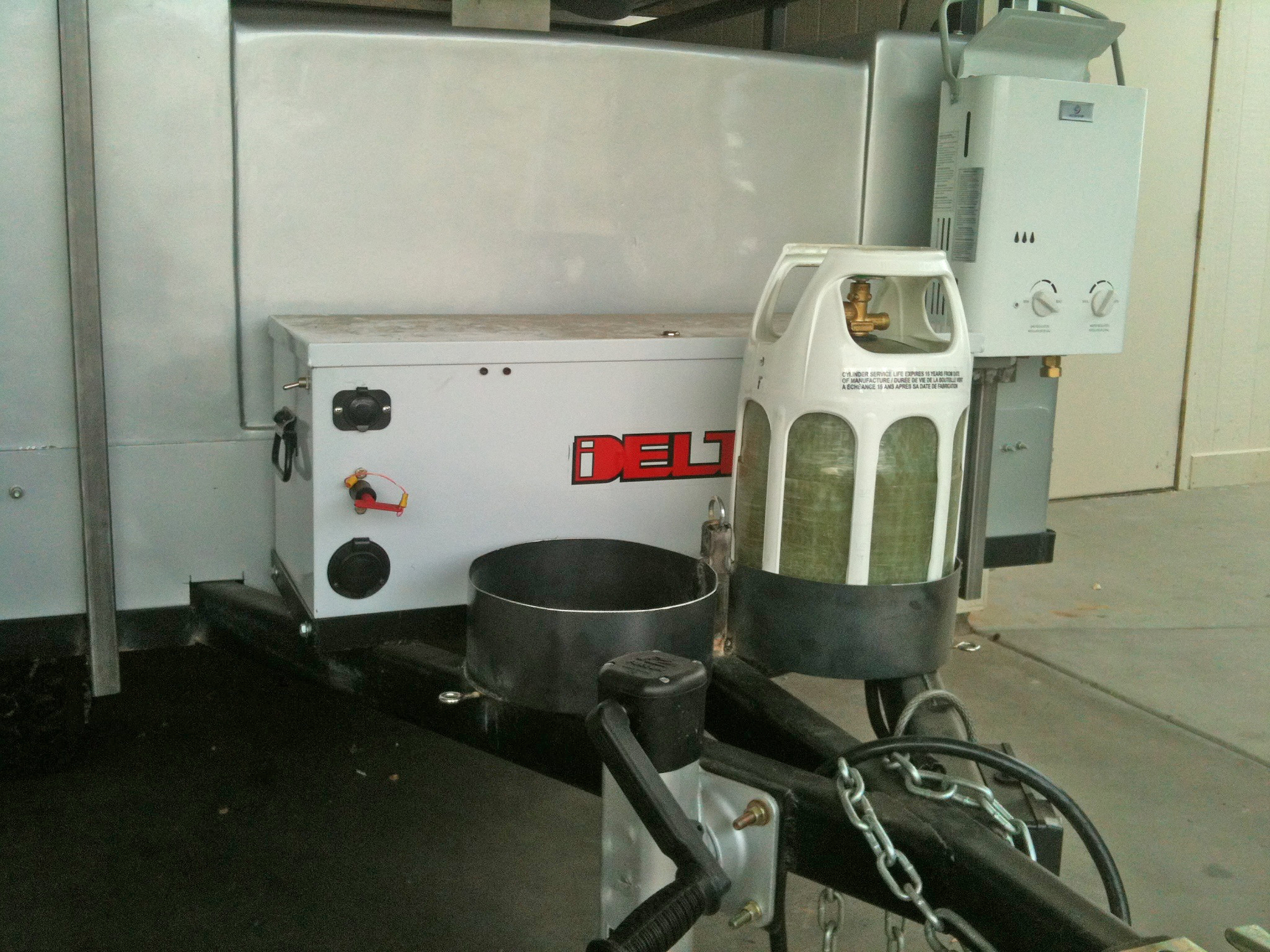

I cant find any type of mount or bracket for the 10# Lite Cylinder thats priced less than the tank itself. So I welded some 5" strips of sheet metal into a 10" diameter frame to receive the tank(s). I then added eye hooks on the sides and am going to use ratchet straps to secure tank(s). I'll paint them black eventually. I'd like to use a lockable straps http://kanulock.com/index.html but again rather pricey. The bike lock will probably keep them from walking off just as well.
I'm going with 2 tanks because we have really begun to use and enjoy our propane 'fire' pit instead of a real fire. Its nice to pull it off the trailer without disconnecting the other one which will supply the stove and tankless water heater.

Thanks. Yep, I bought it thru Amazon, and at $100 its certainly pricey. I justify it because my credit card pays points I can use at Amazon for bling. And the lighter weight tank is really helpful when you get about in a wheelchair. As you can see, I dont have enough points yet for tank #2. I may even make that spot a trash can. Its TBD.
I'm surprised that no one out there is making custom brackets for the Lite Cylinders. Including Lite Cylinder themselves.

I have two lite cylinders as well and am stuck with the same problem. I like your rack, but I would want to have something to lock the cylinder in place such as a welded chain or metal strap that could accept a padlock.
