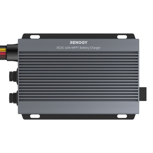

If you're going to upgrade your charging system, check this out
It's a dual charger (DC-DC & Solar) that does everything you want.
I'm actually installing it in my Africa Jeep right now to ugrade the very outdated system. I'll have a video review out shortly.

Thanks, I have looked at that one. I like that it has a 50amp charge rate and handles solar as well. It's something I'll consider, although my existing lead-acid battery and wiring has been working great for years so I haven't decided for sure if I'm going to upgrade to lithium or if I'll just leave the lithium powering the backup sump pump in the house :).

It's unlikely that 16-gauge wire will deliver the necessary voltage and current to the charge controller for it to provide its full output to the battery but the specs of the specific charge controller chosen will have to be checked to see what it needs as its input to provide full output.
Exactly... but you were talking about 2-gauge wire, and that's a lot more stout than necessary. Just need to work the numbers, and size the wires for a modest loss. The Renogy charger needs 8V minimum, so no worries there.
jscherb
Agreed. My calculations for 2-gauge copper were to provide 14.4 volts at 20 amps to the battery at the back of the Jeep, supplied by the alternator, which would be enough to charge the lithium battery fully, albeit not with the recommended charging profile. The voltage drop of my current 2 gauge CCA wire only results in about 13.5 volts, which is plenty to charge a lead acid but not adequate for a lithium.
One thing to keep in mind when calculating the wire gauge and voltage drop if you're using something like the Renogy is that power output has a direct relationship to the input voltage and current: P=EI (power = voltage * current ). So if you calculate your wire to provide the Renogy with 10 volts at 20 amps, the math works out to 10 * 20 = 14.4 * X, where X will be the theoretical maximum output current of the Renogy given that the Renogy will output 14.4 volts to charge the lithium battery. The equation with these numbers works out to 13.9 amps, which is short of the Renogy's advertised 20 amp output (assuming it's a 20 amp Renogy, they make units with different ratings).
