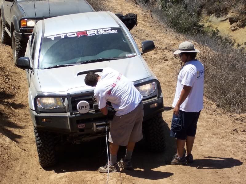

You had to pull out my Taco too at one point when that puppy was brand new!
That was the first time it was ever used, leaving Puntas Cabras in Baja :sombrero:
Here it is in use again 3+ years later. The Jeep Liberty had 31's and open diffs... pulling a Chaser up Mengel Pass was a challenge for them due to a combination of factors. Having a winch is great, especially when it helps avoid trail damage and carnage, and keeps everyone safe!
*EDIT* - the Jeep had a winch... but the power cables weren't hooked up!
ALWAYS make sure your stuff is wired and squared away BEFORE you head out!
