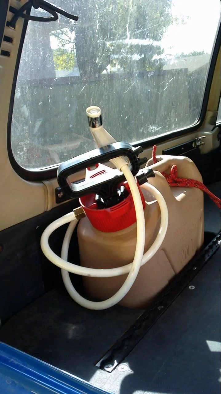

HI Guys,
This is Adrian with Waterport, thanks for all of the honest reviews. We will be releasing a pump cap that will allow you to pressurize the system on the go. The pump is built into the 2" cap and can pressurize the system in seconds(It will fit the existing system). I have attached a photo for reference. If you guys have any other questions feel free to email me direct at africk@thewaterport.com, Im always here to help!! The new pump cap will be $29.99
