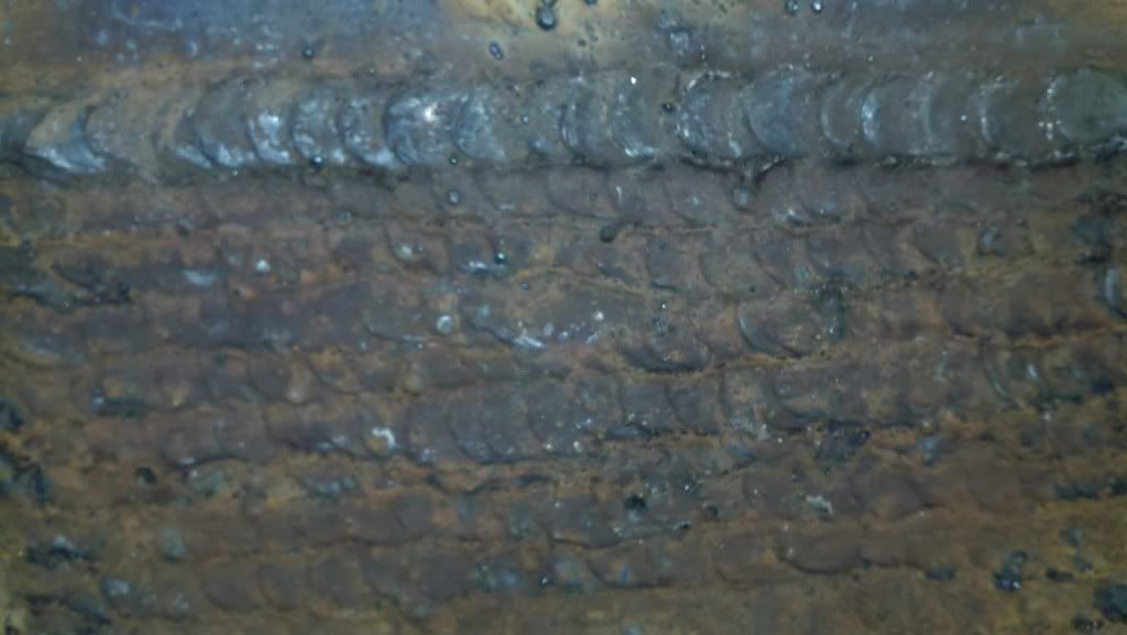

So I decided to sign up for a basic welding course at my local tec school. Since I now have a mig I thought it a good idea to learn a few fundamentals. The program covers stick and mig basics that I signed up for. Having never done any stick before I wasn't sure what to expect but after the first night of welding I feel pretty good about it. we were just doing some basic beads on flat plate to start, but I think I did ok. Thursday we will be running horizontal welds on a vertical plane.
Any feedback for me so far. Instructor is a decent guy but not to much on feedback other then "looks good".

Not too shabby. Take that to a wire wheel and put a nice shine on it! You'll really be able to see the dimes!
Finished welding school back in May, really enjoyed it. Your beads will start to get more "sexy" looking as you go on with it. Try holding the stinger at different angles, shorten the rods, find out what works for ya, and lean on something. You don't want to be standing trying to stay still while welding, way too hard.

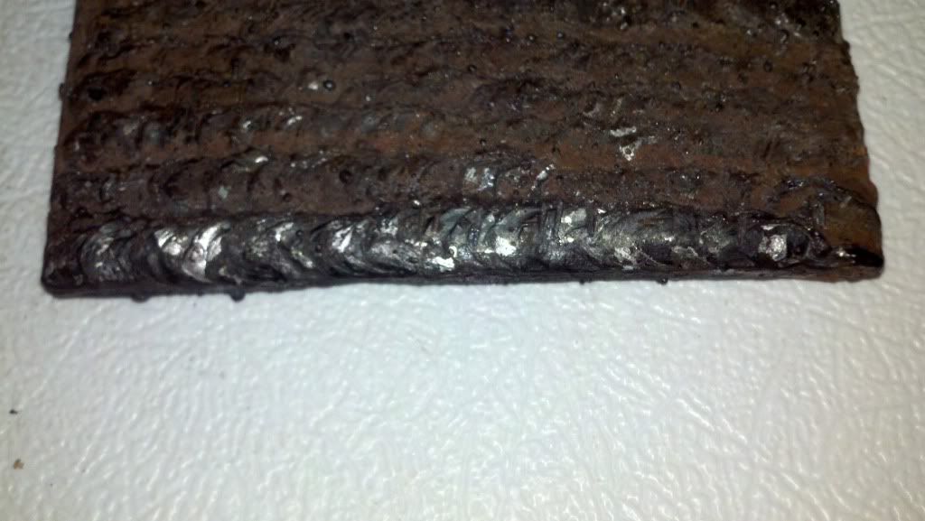

My 5 week test. Went from never touching a welder to laying this down. Almost a perfect plate.

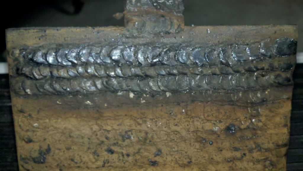

Ok so last night I was running horizontal beads on a vertical plane. Nothing spectacular yet but I think it is still looking ok for a newb. Tuesday is my next class and he is starting me on doing T welds so I will finally get to put some metal together. Looking forward to that for sure.
It's interesting how many more things there are to think about when going to a vertical plane. Angles change, gravity, heat working up your piece into your next weld line etc.

Definitely on the right track. You using 6010?
I'm a HUGE fan of 7018! The beads I can lay with that rod will make a baby smile. :wings:

6010/6011 is a great all around rod, plus it isn't picky about the cleanliness of the material(need to weld something fast with minimal prep-6010). As far as the 7018 goes, it is one of the easiest to lay good looking beads with. It is however much more demanding in the material prep department.
