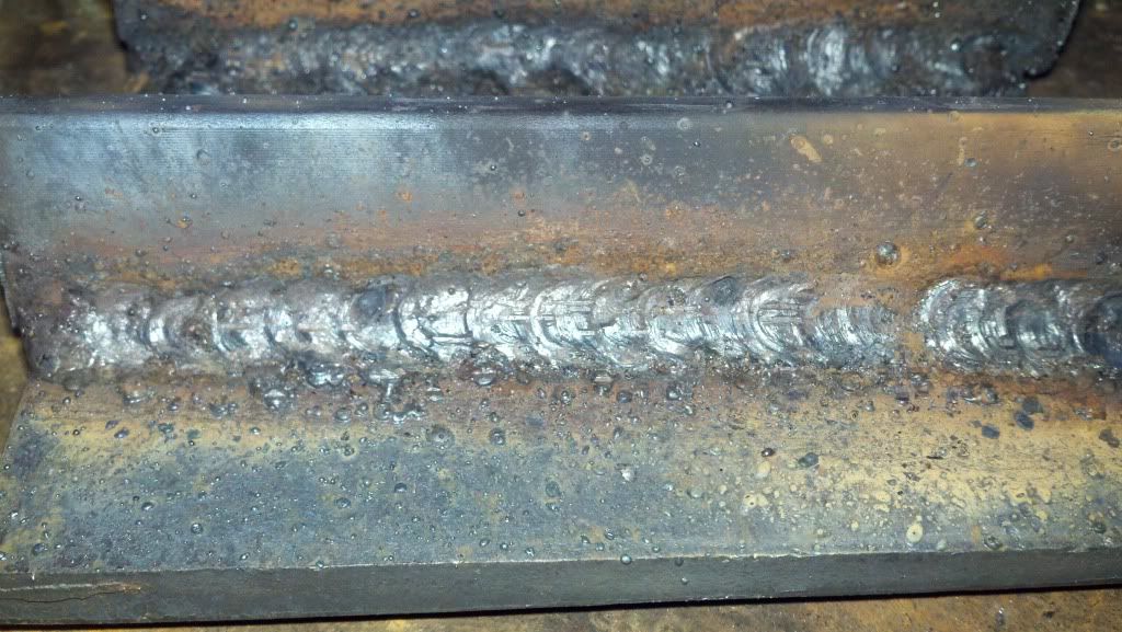

to the OP looks like you are on the right track,nice work now for the critique you weld looks either a little cold or you were traveling a little fast. An easy formula for stick welding is use the rod size for your starting amperage
example= 1/8 rod (.0125") start at 125 amps
3/32 rod (.09375") start at 94 amps
then go up or down from there depending on you base material thickness
With 6010/6011 rod you are going want to "whip" it a little, about 1 1/2 times the rod diameter(not too much or you will get slag inclusion in your weld). Keep at it there nothing more satisfying as doing it yourself:victory:

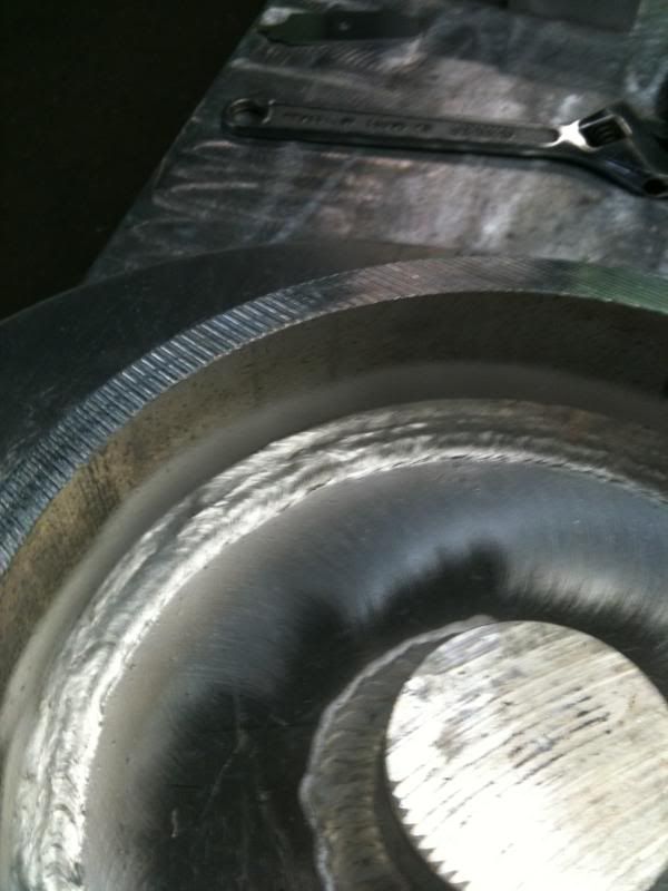

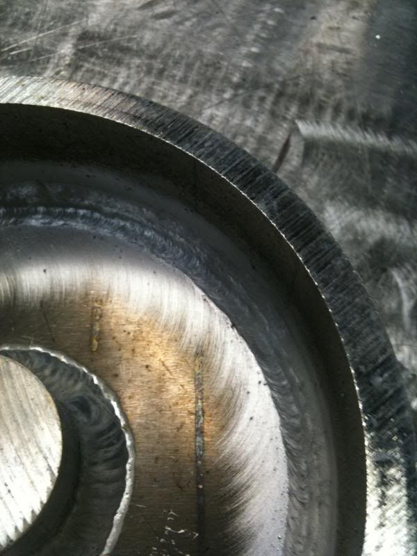

Next thing you know you`ll be making welds like this:
6061 MIG
6061 TIG
I have been a welder/fabricator for 18 or so years:ylsmoke:

So here is a question. When I whip the electrode out of the pool. Do I let the pool dry up before I come back in. Or due I reintroduce it before the pool is still molten.
R_Lefebvre
I can't comment too much about your stick welds you've shown, other than: Don't concern yourself too much about the "stack of dimes" look in the welds. Much too much emphasis is placed on that by vehicle fabricators, and it's really meaningless. In fact, a smooth weld bead will be stronger than a pretty stack of dimes anyway. The dimes create stress concentrations.
Warhead
you don`t want to go all the way out of the puddle, if you leave the puddle you will have slag inclusions. just whip far enough forward that you see the base metal melt creating a void then pull back to fill the previous void(slight pause).
It is hard to explain with words, I hope this helps

Thanks for all the continued feedback. It has helped for sure. Here is last nights first run at actually fusing metal with a T joint. Things definetely got more difficult. I was overthinking it in the begining and spending to much effort managing my angles with the rod. Later on I slowed down and got a much large weld pool that filled in the joint better. However I think I am long arcing a bit after looking at some of the work since I am getting a bit of an undercut on the vertical plate. I'm going to try and modify that on Thursdays class.
