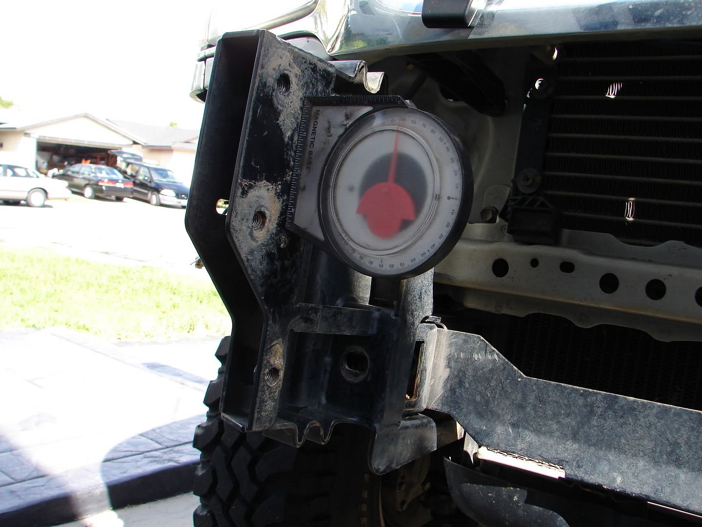

I am thinking about having my ARB bumper brackets welded directly to my frame where the three bolts are. I am looking to get the most strength possible out of the bumper. I have already had a bad recovery that bent my frame where the ARB attaches to the frame and only have two of the three bolts holding it on...
Are their any negatives about doing this? I want it to be a step above the end-cap mod so I will never have to worry about the front end strength again.
I will still be able to remove the bumper from the brackets so that should not be an issue.

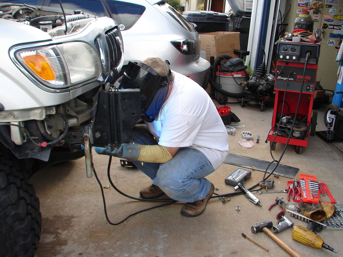

With the help of an awesome fellow ExPo member: :bowdown:

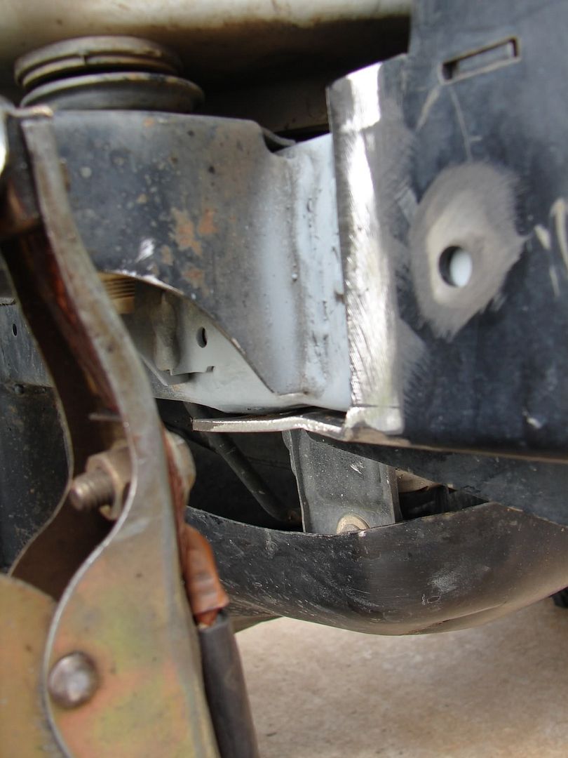

My solution to the end caps with my 07 was to take 1/4 bend it on both ends and weld it after the bends. You can see in this picture where the added steel was welded in and I had to change some of the other brackets were mounted.
Hope this helps. Let me know if you need more pics.

With the help of an awesome fellow ExPo member...
I'm curious what inspired the 'fully welded' instead of the traditional end-cap mod? The nice thing about easily replaceable crush-cans (the accordian formed mounts you welded to the frame) is that they can be replaced for a reasonable $$$ if/when they get tweaked from a wreck or a bad recovery situation. That said its pretty rare to need to replacement.

As I sad I had a bad recovery and the bumper mounts no longer worked properly. The end cap mod is great but I had an issue with every bolt on the passenger side. The strength of the bumper mounts feel 1000% better than the way it was before.
If I have an incident that results in the the "crush cans" actually being crushed I would need a whole new bumper if something caused that kind of damage. Would just chop off the old mounts and have something custom made.
It is now part of the truck and no longer held on with a few loose bolts.
It may not work for everyone, but I love the results. I am no longer worried about the bumper getting ripped off the truck when I need it most.
