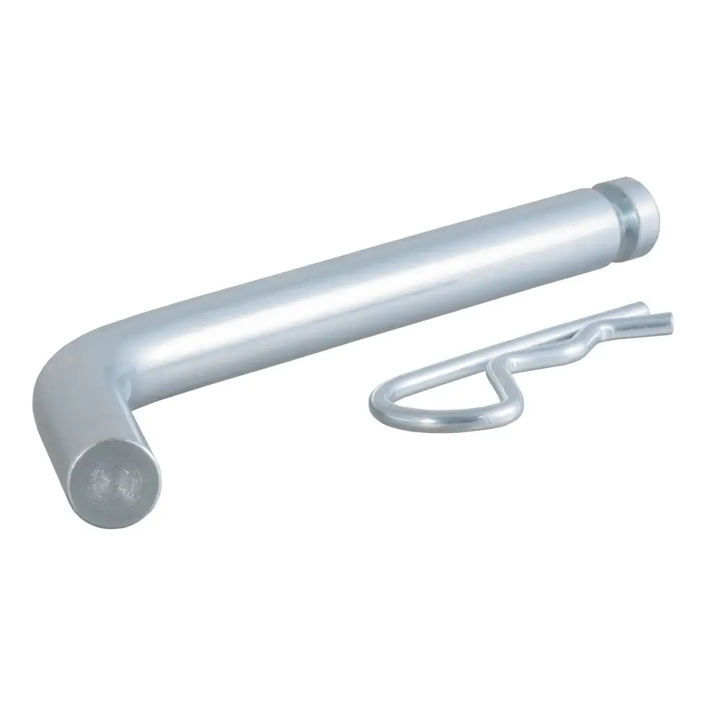

What would I recommend for a hitch pin.....
A Curt 21507 is rated and tested to operate it's entire life at 21,000lbs by the manufacturer. It has a lifetime warranty against breakage. That 21k number may seem 'low', but that is including what I would say is a HEALTHY factor of safety to account for the service life and fatigue cycles. These are typically $10 or less....commonly $5 shipped on amazon.
MasterLock 1465DAT. These do not have an official rating, but they still do still come with a lifetime warranty against breakage. I like these units because of the integrated retainer that you can't lose, but they still retain a solid pin. These are listed as stainless steel. They are $20 at your local tractor supply, Amazon has them for $11 commonly.
Not many manufacturers I have found offer a 'rating' or a warranty. I don't think the hitch pin is honestly THAT much of a point of concern as long as it is properly supported. If you want to use something like a grade 8 bolt, make sure that the unthreaded shank extends completely across the hitch. You do not want a threaded section loaded in shear. The reduction in minor diameter makes it much weaker along with the sharp corners of the treads will lead to fatigue cracking over time. ( not to mention the threads chewing up the host tube ).
I hope that helps.
