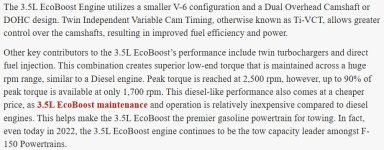

Same here. My 2016 that I bought new has been trouble free. My understanding is that the newest version of the 3.5 Ecoboost puts out 500 lb-ft of torque - that's almost what the 5.9 Cummins in my 2004 Dodge has. What's amazing is that 90% of that torque the Ecoboost puts out is available at 1700 rpm - just like a diesel. That's why it pulls a trailer so well. I'd consider a newer F150 but I don't trust the new 10 speed. The 6 speed in my 2016 has been trouble free.
Exaclty. The low end torque is what prompted my move from a 5.0L to a 3.5.
