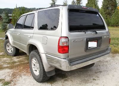

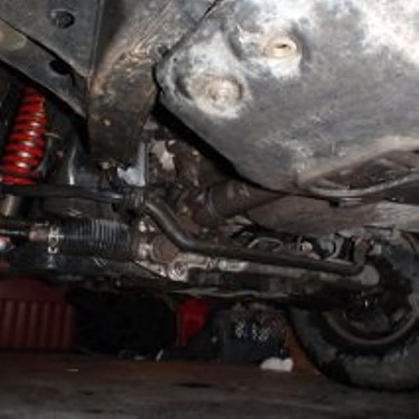

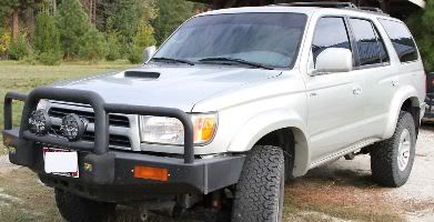

Looks like pretty uneven tire wear on the front, with a bumper that is improperly fitted (looks like a TJM).
Looks alot like what my truck used to look like, before I started bolting and welding a bunch of expensive crap onto it.:sombrero:
The truck looks pretty clean. Doesn't look like its seen too many trails. This is a mixed blessing. Probably means it has not been rode hard and put up wet, but also means that some of the key components have not been used often.
Be sure to check to see if the locker engages, cuz the actuators tend to seize up if unused. You have to be in 4LO for the locker to engage (but there is something called the "gray wire mod" later if you wanna change that)
Is the transfer case shifter a lever or push button? Is there a locking center diff?

Ok, here's what I found. Thoughts?
2000 4runner, rear e-locker, AT, cloth interior, sport hood(scoop),
120k on truck, TRD S/C installed at 80k by dealer
timing belt done at 90k, body looks clean
3.5" racerunner coilovers, ARB like front winch bumper with pia's, performance exhaust, needs tires 2nd owner, original did all the work. Asking 9,900, might go for 9k. truck is out of state so I'd have to fly and drive, or fly home if it's not as represented.

I'm a cheap bastard, everything seems too expensive to me! My thoughts would be to find a completely stock truck and mod it to my liking or buy an already modded truck that's completely built. That's not a whole lot of truck for $10k:Wow1:.

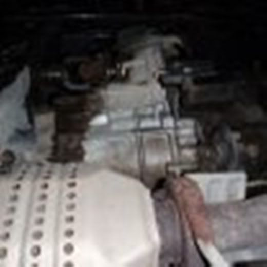

I looked at the links, but still cannot determine what is water and what is leaking parts...
I'll agree with RusM, however. I would not pay 10k for that truck. Its a nice truck, but not worth 10k. Heck, when I was considering selling my (almost fully) built 4Runner, I was thinking about 10k. 10k should buy a low mileage completely unmolested truck with service records (and you would still have to dump cash into it to get it built up), or a very built truck that has modifications that have already been shaken down.
Try to get some more pics when the truck is dry, and try to get the price down a bit.
