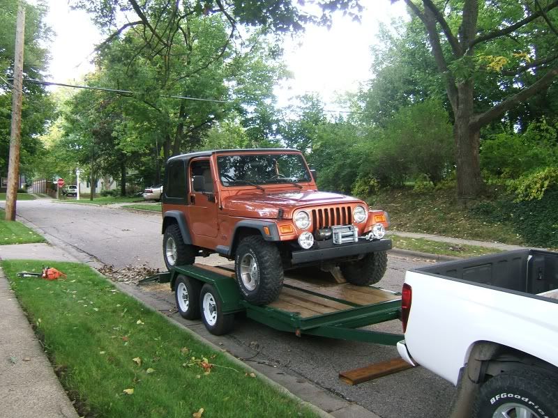

Whatcha planning on welding? That's really going to be the determining factor. The second question is where you will be welding.
I went with a 110v Lincoln when I bought a welder a few years back, largely because I was living in an apartment at the time and I was welding on my patio. It is capable of doing 3/16" stuff in one pass with flux core wire, and only once has the duty cycle been an issue for me. Duty cycle may or may not be an issue for you, depending on the work you're doing. Note: a 110V machine REQUIRES 20A. 15A wiring and breaker won't work, it'll be tripping the breaker any time you turn the juice up. I run my welder off a portable generator, since I haven't run 110V/20A to my garage yet.
If you have 220V where you plan to work or if you're going to have to pull wire anyway, you'll probably want to go with 180A (or more) machine running on 220V. You can still power it off a generator if need be, but you'll have a lot more capacity at for the thicker materials.
Opie and his Lincoln 180A 220V built this:
