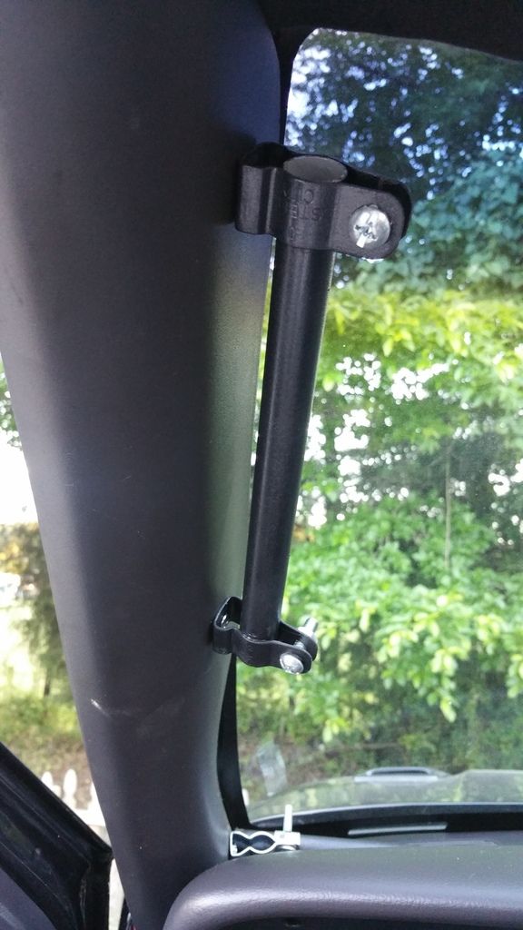

Looks nice. I made my own out of 1/4" conduit and 2 conduit hangers. Got a A-Pillar trim piece from the junkyard and just mounted it to the A-pillar. Then ordered a handlebar mount for a bike for my phone.
Here is the mount itself: http://www.amazon.com/Roam-Co-Pilot...&redirect=true&ref_=oh_aui_detailpage_o00_s00
I need to find a pic or take a pic of the mounting point on the a pillar. Let me know how it does. I plan to install a charger that will reach the phone up under the dash as well.

There it is mounted. It seems very sturdy, and has a rubber wrap around thing that holds it even tighter, I'll get a pic of it with the phone in it when I have a camera around....besides my phone, lol.
