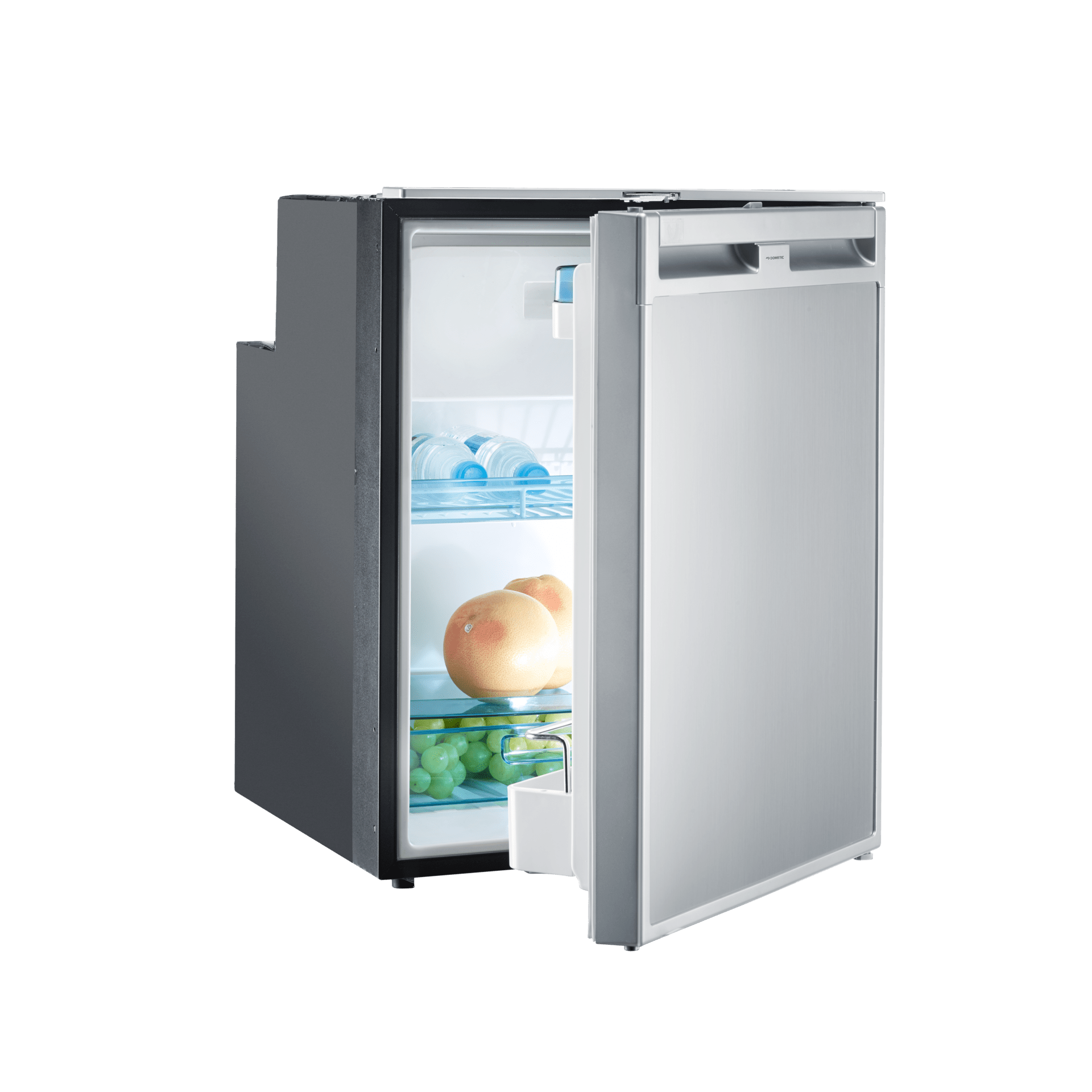

I have not yet bought a new one but I'm looking at the Dometic CRX Series which are very energy efficient.
