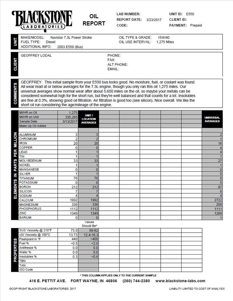

It's the 7.3 correct?
Should be a sticker on the valve cover, and it's etched into the machines surface the oil filter housing is bolted to.

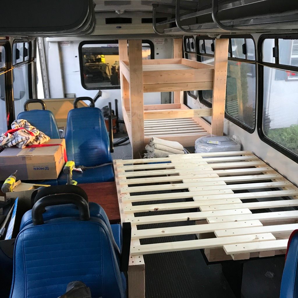

The seats that are coming out are out, if anyone local needs any I have a dozen. Freedman, lightweight, 4 bolt mounting, I'll give you a hell of a deal. Same with the wheelchair lift :). Next up is building the table mechanism and the remaining furniture, which shouldn't be too crazy. I also need to build a curtain to close off the cab when parked, as well as window coverings that have some level of insulation. If anyone has budget suggestions here I'm all ears, trying to keep this build stupid cheap.

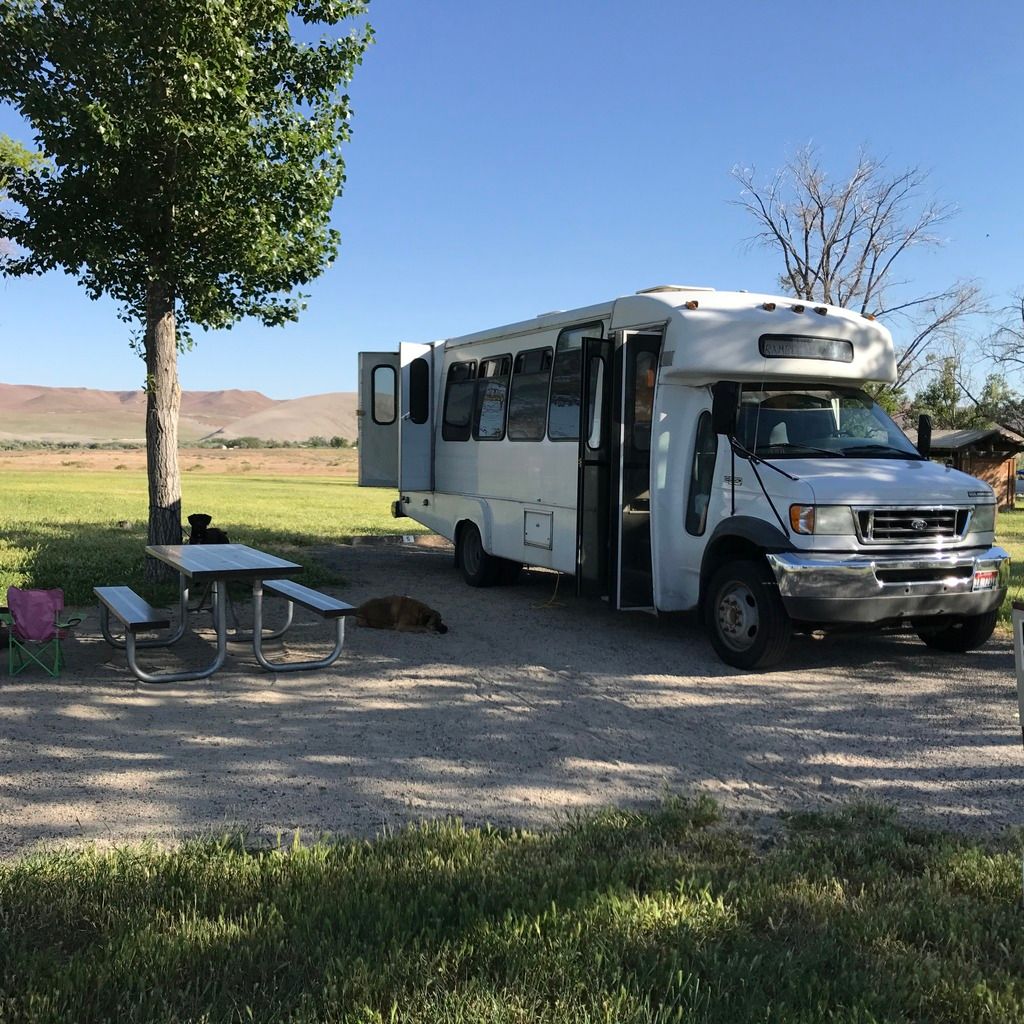

Maiden voyage this weekend. It was absolutely wonderful having that much room, and no major issues to boot. A few minor niggles to sort out.
