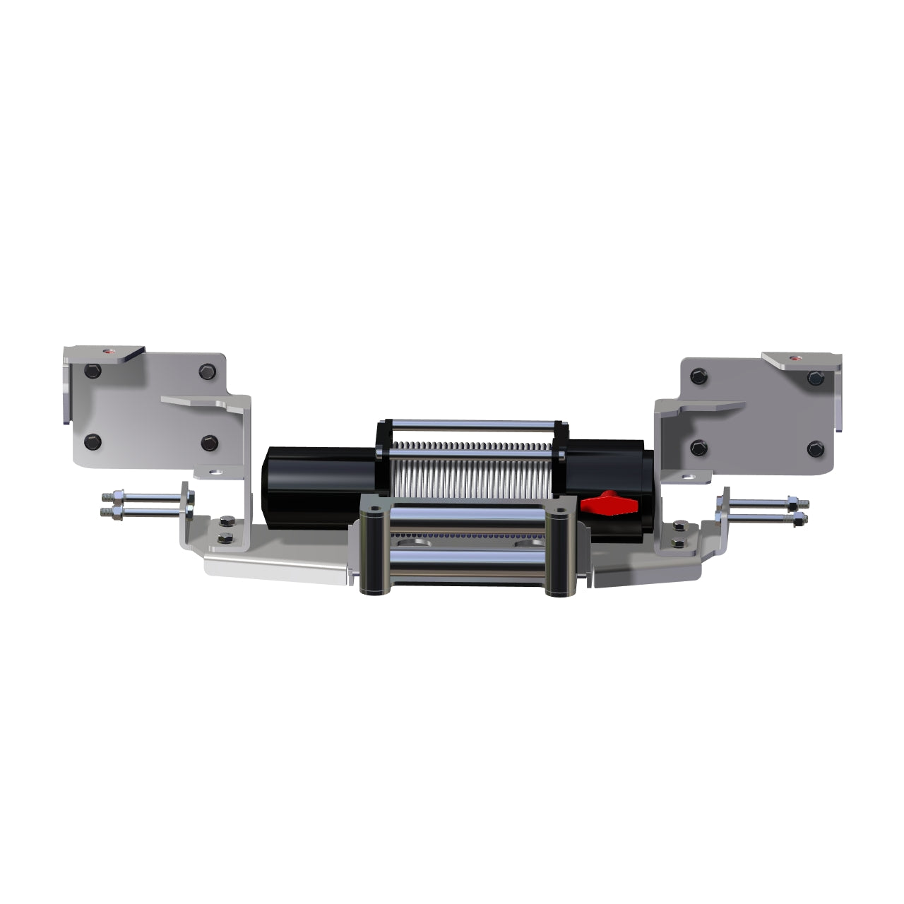

Metcalf
pith helmet
Well-known member
Yep. I know people with 3/4 tons with those on order. It’s my 1/2 ton they don’t have anything for at this time.
