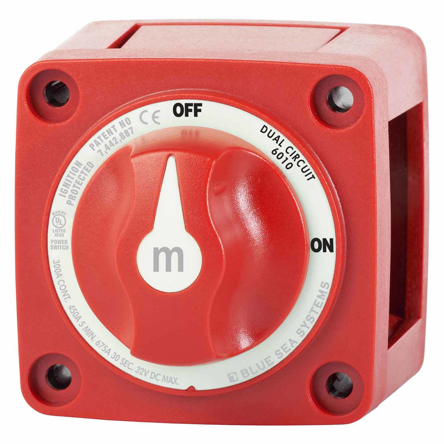

This does not answer your question directly, but here is what I have installed between my battery and my winch:
I have it 6 inches off the Positive terminal of the battery. The reason for this is that I was not comfortable with having a live positive of 0 gauge wire on the front of the Jeep. In the event of a wreck, there seemed to be too much potential for the wire to suck every last amp out of the battery. So I installed this big honking switch to air gap it when I am not using it. After a few years of use, it shows no sign of any issues and I am very happy with the results.

I use a 300 Amp rated switch which is located right next to the battery. I just leave it off until I need to use the winch.
