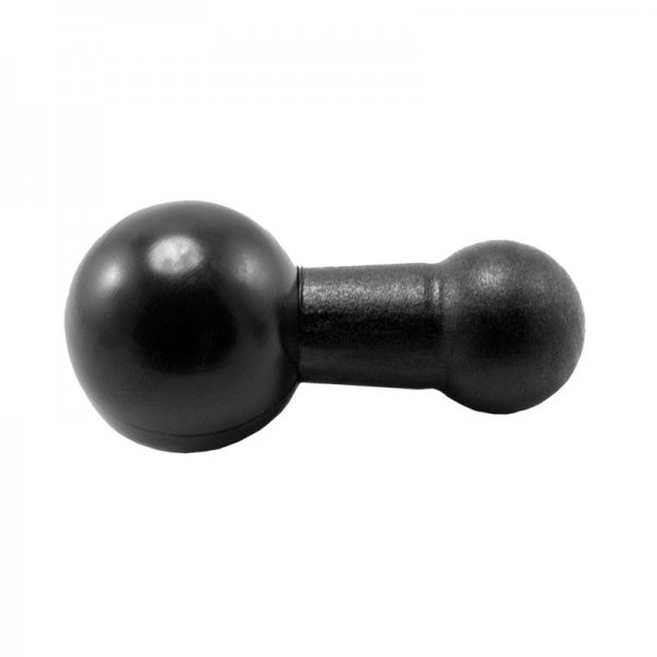

And this seems to be the adapter for G-Ball to Ram 1" ball:
https://www.rammount.com/part/RAP-SBA-RGU
That is indeed the correct charger but thats actually the wrong ram adapter. I purchased that one from ram and ram's website says its the correct size but it's not. The smaller ball fits but the bigger end is actually smaller than the 1" ram.
As far as I can tell Ram actually doesn't make a direct adapter for the 17mm g ball to 1" ram
Here is a link to the correct adapter
https://www.gpscity.com/arkon-1-inch-ball-to-17mm-g-ball-adapter
