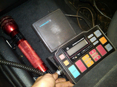

Here is where I mounted mine. It is the cheap $14.00 one from Ham Radio Outlet...works VERY well and I am happy.
Have an identical one on the opposite side of the console for my CB

Nice job barlowrs, looks slick.
