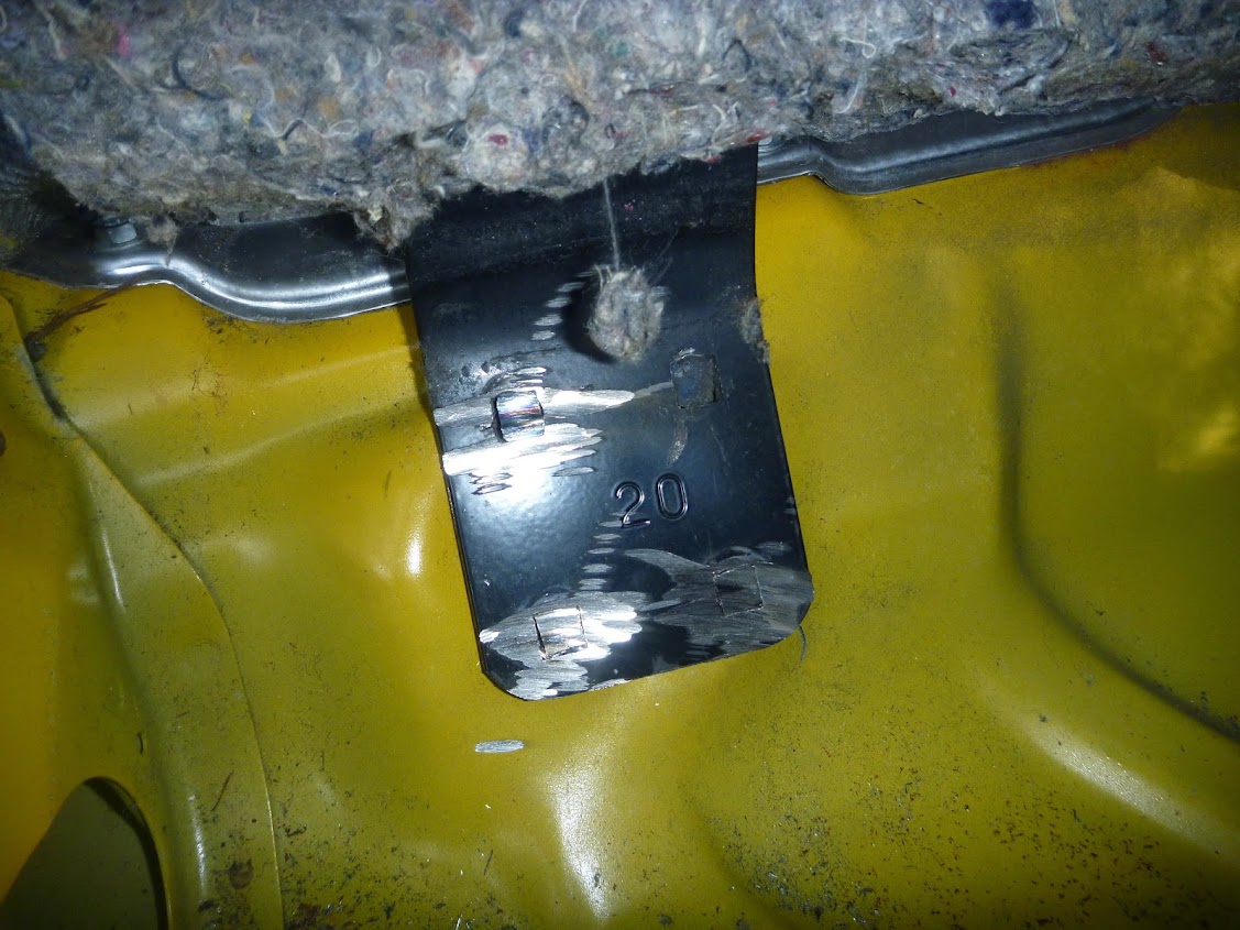

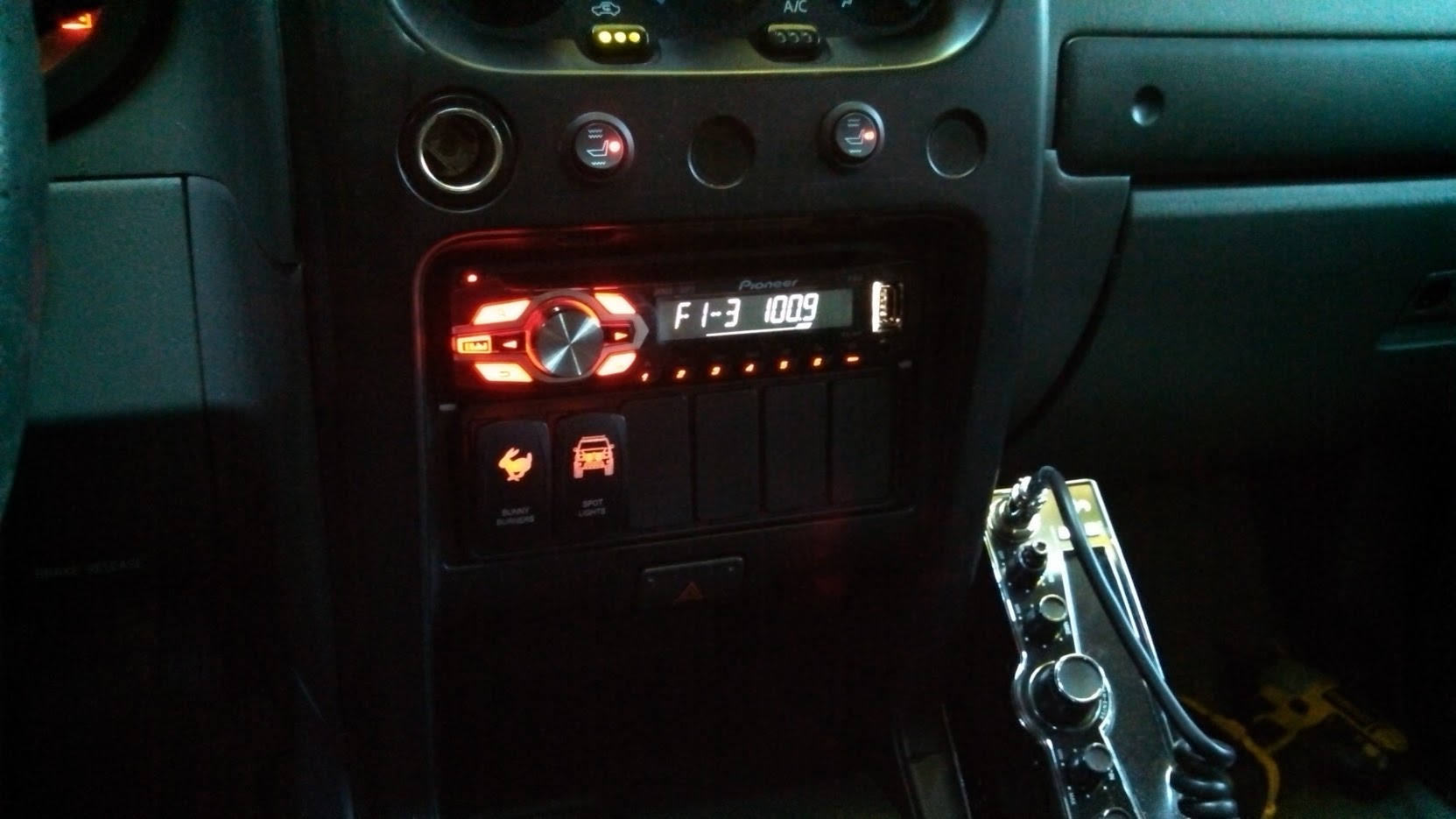

The truck came with this shiftier lock thing. i do not live in any sort of bad area and can't imagin needing it so i ground it out
so i could make room for the CB

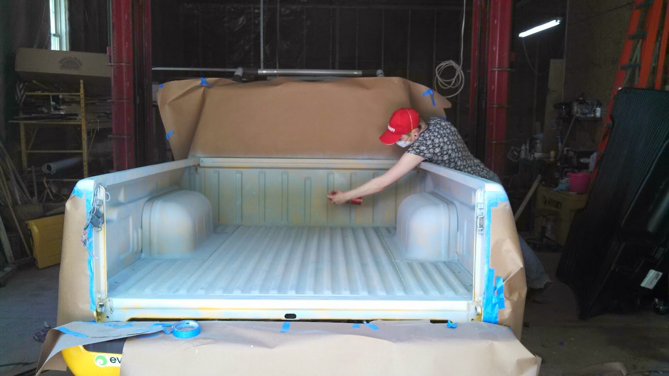

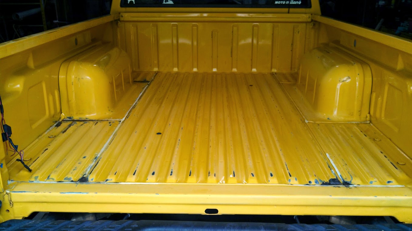

I pulled the old plastic bedliner out and scrubbed the entire bed taking extra care to wire wheel any rust spots I found down to bare metal.
I then uses U-pols Acid etch primer over the entire bed and rails.
this is my GF hitting a few spots again
using the gun I got with it I sprayed the entire bed and rails.
i think it turned out rather nice

Nice job on the bedliner. Thinking of doing the same on my 2012 Frontier. The drop in plastic bedliner wastes a lot of space and where it hooks over the top of the front of the bed keeps the Leer topper from making a good seal. What brand of DIY bedliner did you use? I can't quite read the can label in the pic.
iron dingo
I used U-Pol's Raptor i believe the Custom Coat is the same stuff with a different label.
it seems to have worked quite well we will see if I did a good enough job with the prep. Make sure you have plenty of light and wear a mask with a carbon filter it smells strong.
when I pulled out the plastic bedliner I found a lot of dirt and crud under it as well as a few rust spots, it did not seem to really be protecting the bed all that well.
