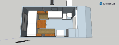

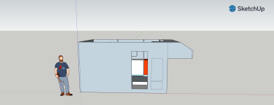

Took some measurements and started brainstorming layout. Here's an incomplete mockup. I'd like to raise the roof 10" and build a cabover sleeping loft for a full size bed. The main bed will be a elevator style queen size in the rear area above the garage.
So far, I'm thinking of using a 45gal wheel well tank for fresh water underneath the passenger side bench seat. I'll need to remove the top portion of the storage box behind the passenger side wheel well and there should be enough room to mount the water pump under the seat as well. Should still have 6in of storage under the bench cushion.
A 35gal gray water tank will go in the bottom of the outside storage cabinet next to the bathroom. The goal is to distribute the weight across the ambulance. A 10.5gal black water tank is integrated into the shower pan.
To build the bathroom, I'll need to remove the upper storage box behind the driver seat and a portion of the upper part of the cabinet where the gray water tank will be located.
Not sure on window locations yet, pretty sure I want a large window in the rear but that will require chopping rear doors in half - still want access to the garage.
