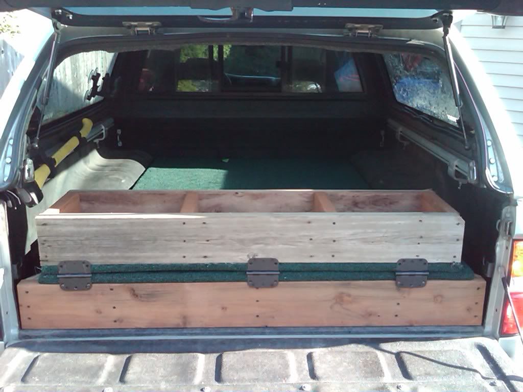

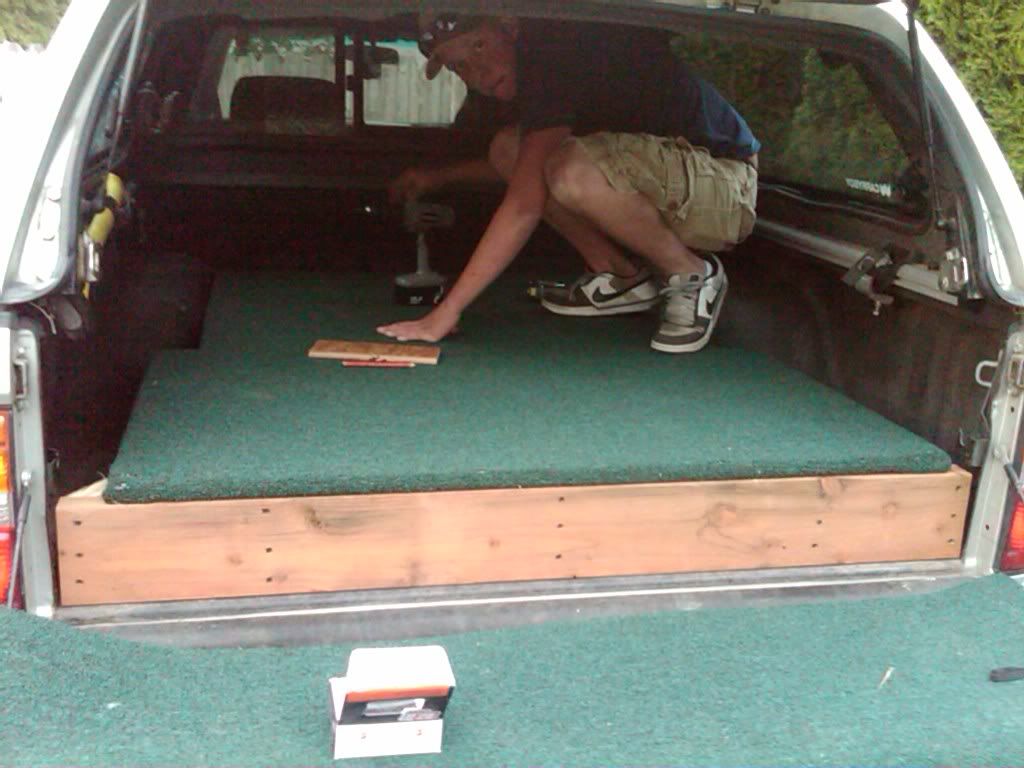

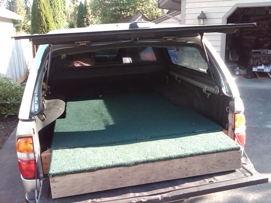

Resurecting this thread to show off my newest addition in preparation for my exploration from olympia, WA east through Idaho, Montana, Wyoming. It is a pretty simple set up, I wanted it to be able to slide out as a complete unit for when not in use. I insulated in between to help out with those cold nights and carpeted the top for looks and functionality. I wish I had taken the time to snap some photos when building was in progress but you know how it gets when you get involved in something and don't wanna take the time! :smiley_drive: The basic design is a box frame with center supports built with 2x4's and covered with a 3/4" sheet of plywood. The end of it is hinged so that I can utilize a 12" longer section because of the shortness of the DC's bed, yet still be able to swing it up and shut the tailgate.
With the TruckBedz laid out

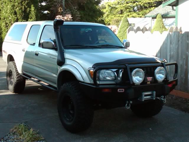

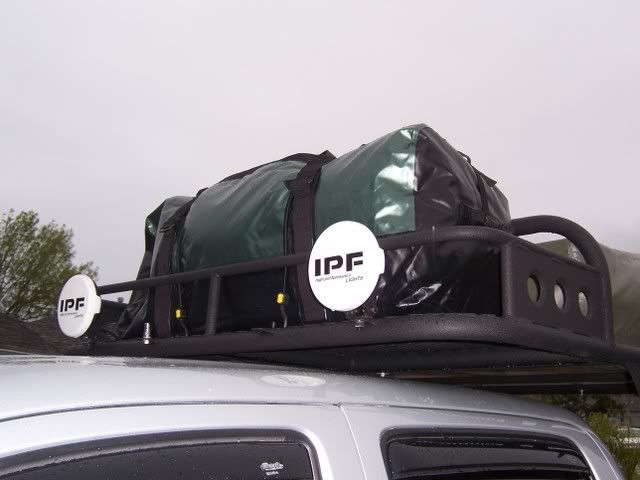

Just a shot of the truck so far...4x6 Conn Ferr roof rack going on this week!:wings:

That is hands down the most ingenious setup for a full length sleeping platform in a short bed Taco I have ever seen! Awesome idea! :Wow1:

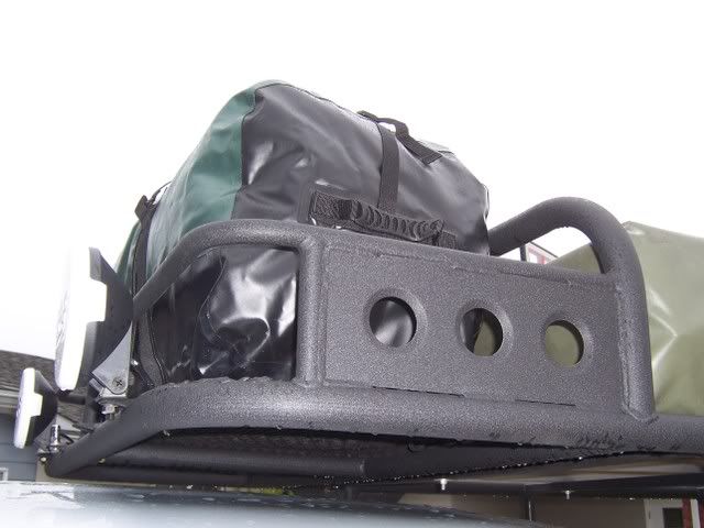

Boundary Waters Waterproof Bag from Cabelas holds sleeping bag, pillows, clothing etc. and keeps them dry up on the roof rack. This is the Magnum size and is very durable IMO.
