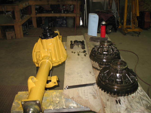

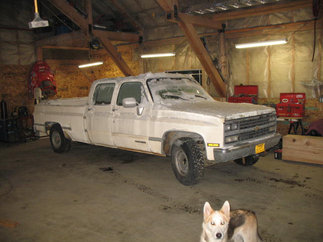

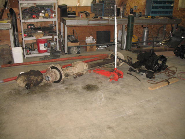

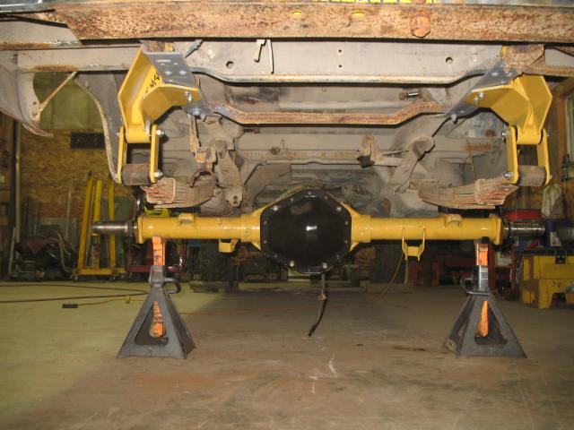

So for where I live and the local trips I take I needed something that was large enough for a family of four and able to carry enough for us to be gone for up to 16 days at a time, not just 16 days on the road but 16 days in the bush with no other outside contact besides sat phone. I also needed something I could drive on the highway 300 miles in a weekend take off the pavement and be able to ford 48 inches of water or mud if not a combination of the both.
It started with a 2wd 1989 crew cab chevy that had blown small block and non working automatic items added include a Dana 60 front axle with crossover steering and hydri assist from PSC a new model rear 14bolt with disc brakes and a detroit locker a fuel injected big block connected to a sm465 and NP205 transfer case as well as a 12K warn on the front and an 8K warn on the rear.
This truck also has to be able to lift my fish wheel in and out of the copper river and hoist a moose up and into the back during the hunting season.
Pics from the start to current

Really nice looking truck there rdrash! I like the way you used those track bars to keep the front axel at the right angle. Nicely done!:drool:
