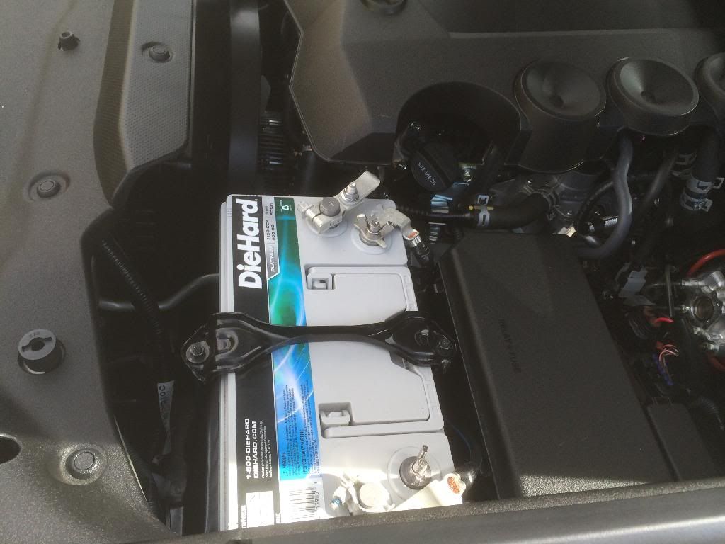

· Diehard Platinum PM1 in stock location

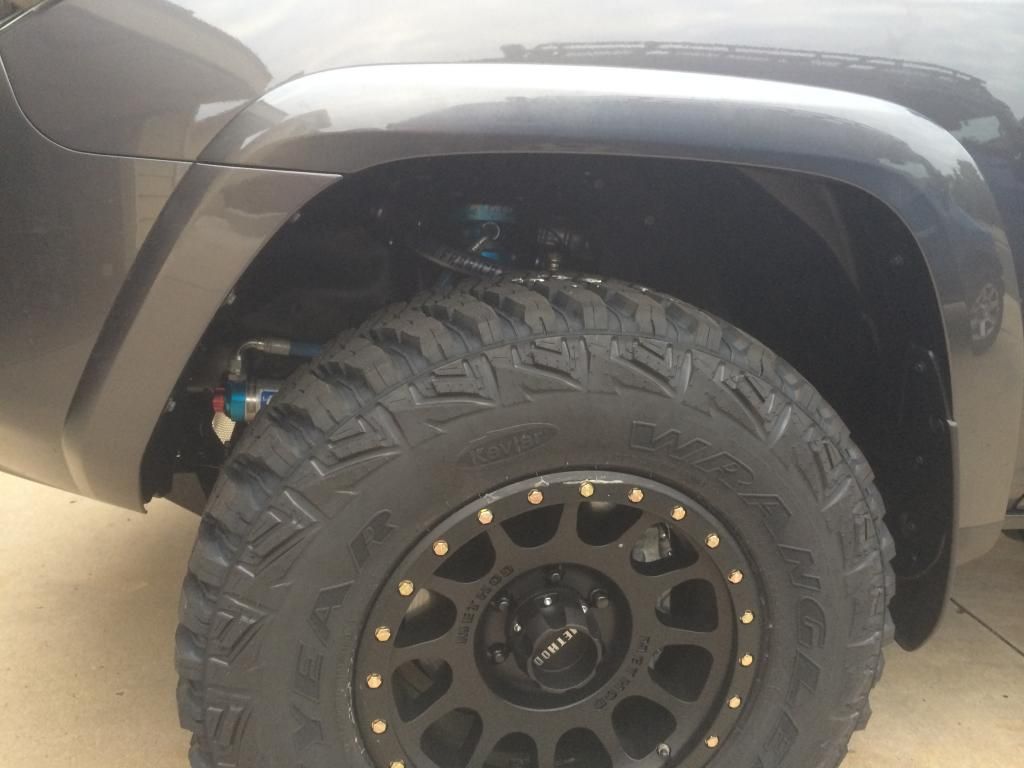

· KING OEM performance Coilovers w/Compression Adjusters
-550lb Coils
-Inner spacer shortened for extended down travel
-Custom Reservoir Mounts due to KDSS
· Total Chaos UCA’s
· Total Chaos Spindle Gussets (for Swaybar)
· Wheeler’s Offroad BumpStops

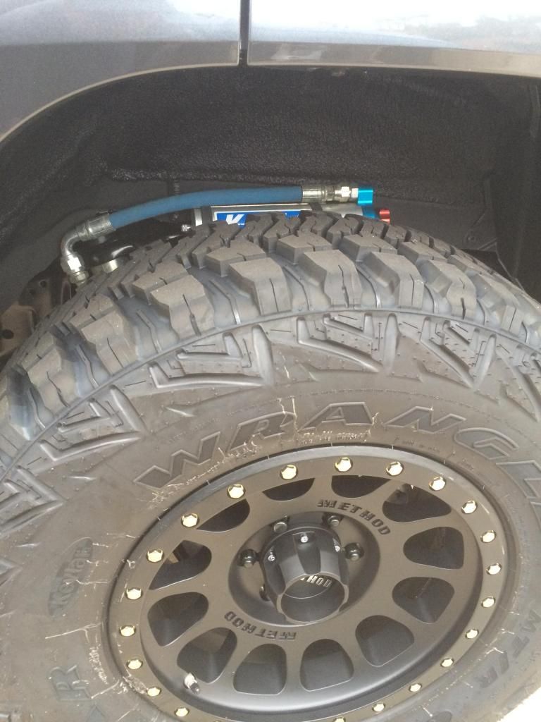

King OEM Performance series with compression adjusters ( From FJ with modified reservoir mounts due to KDSS. also added 285/70/17 Goodyear MTR's on Method Racing NV's

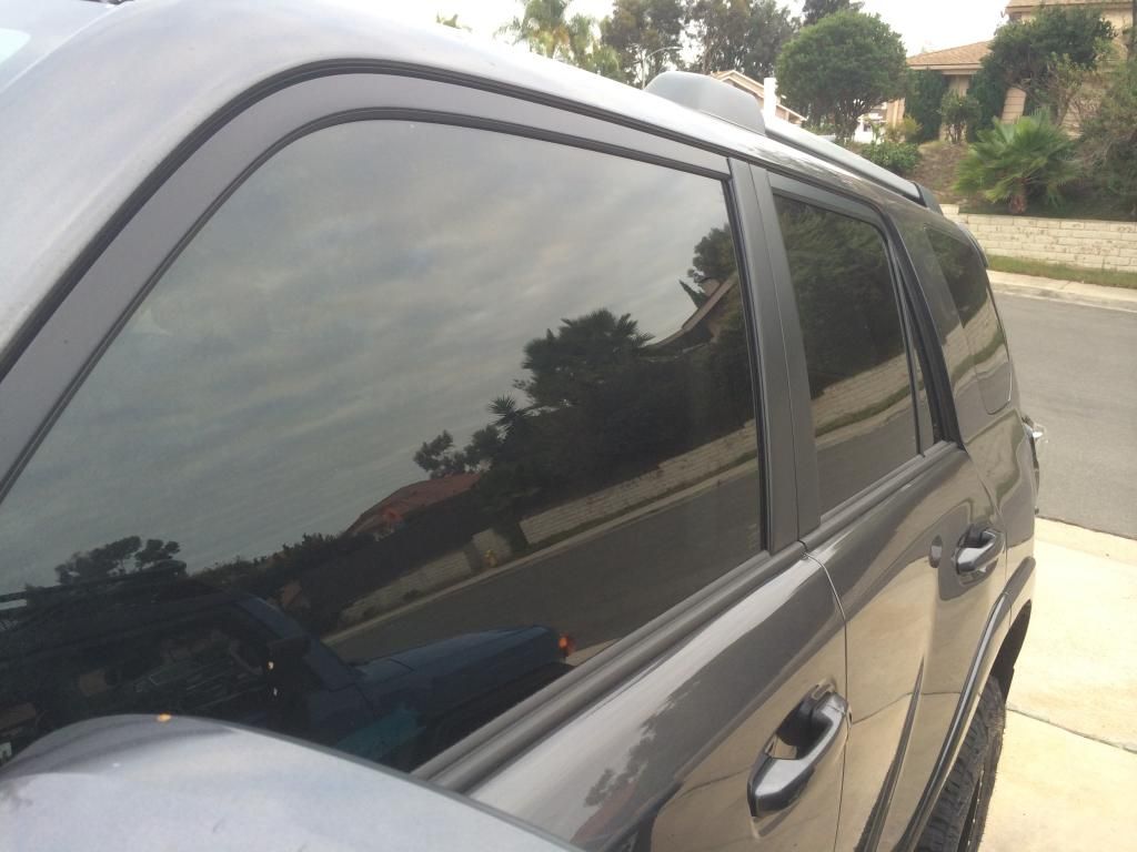

22% tint

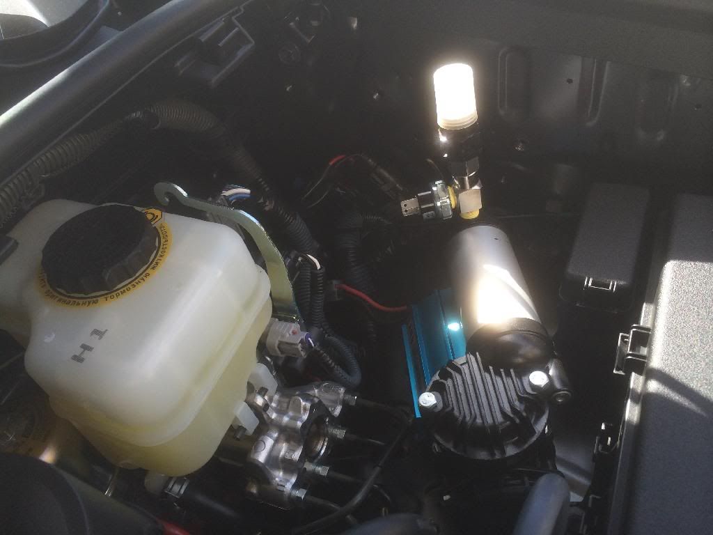

Added an ARB compressor
And a Diehard Platinum Marine. I think it's a PM1
Both came out of my FJ

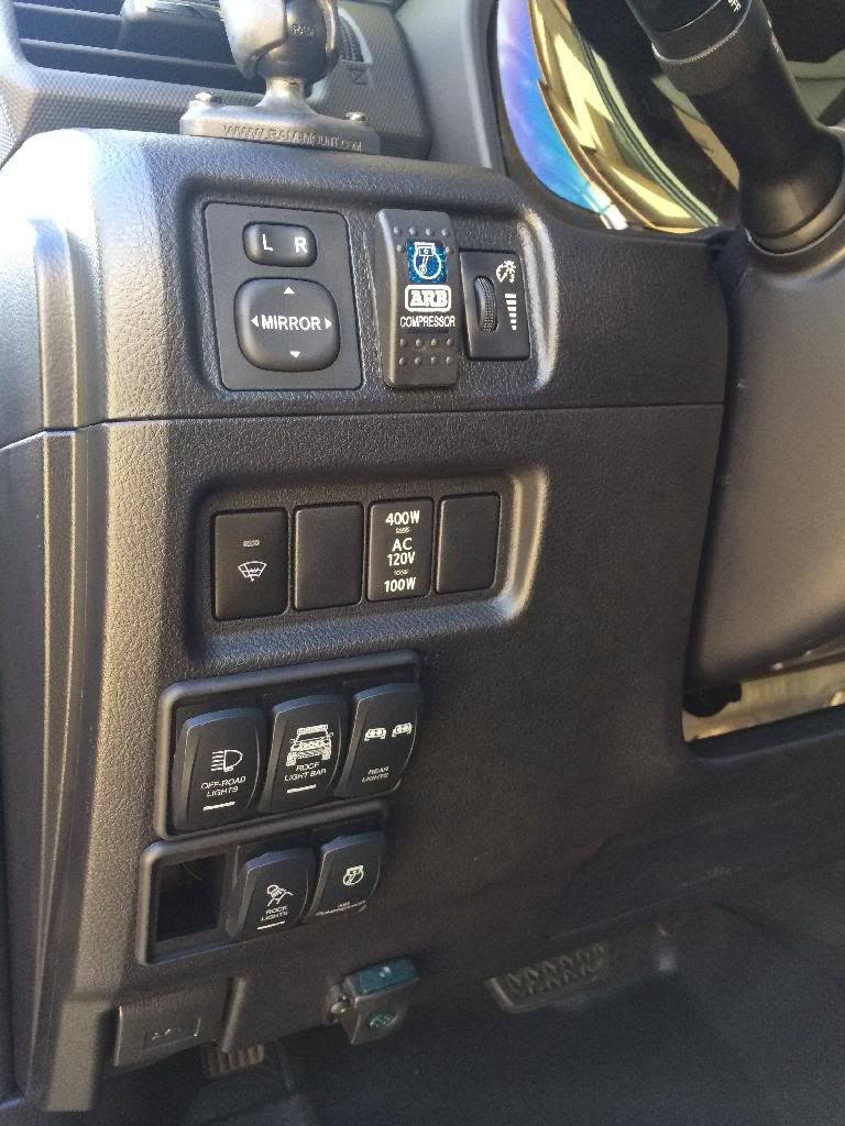

Got my ARB compressor and OTRATTW switches in and partially wired up.

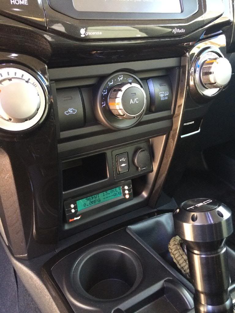

And mounted a Scanguage II with some
3M VHB tape.

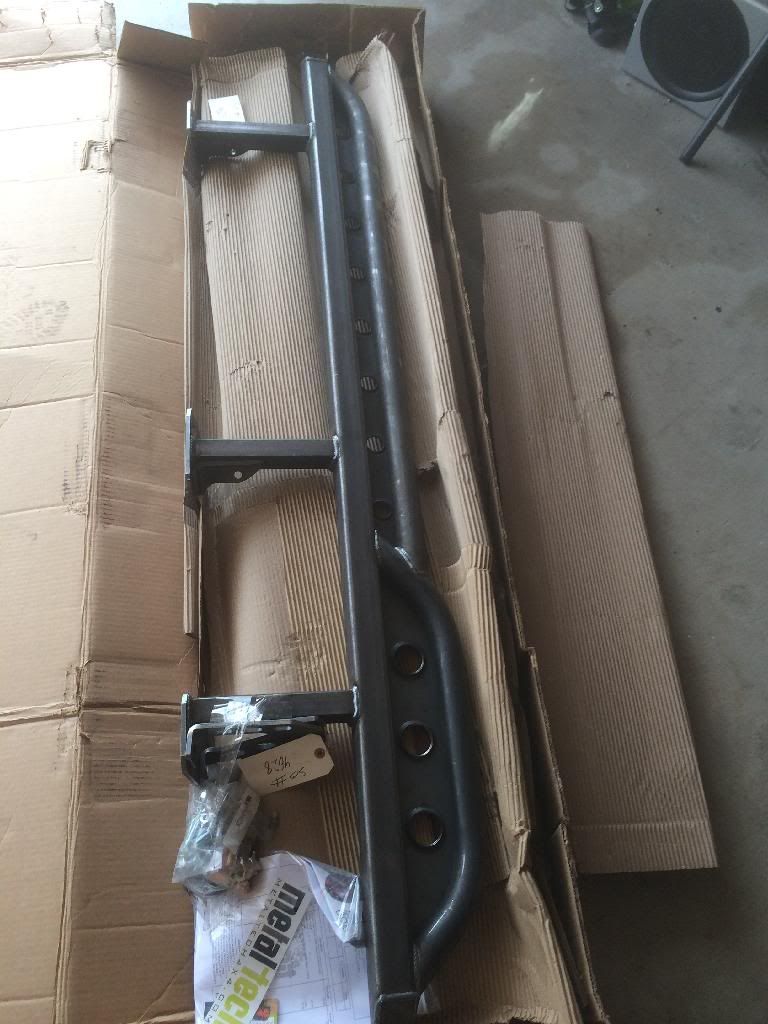

Got in my OPOR sliders in. Now to get them
Line'xd

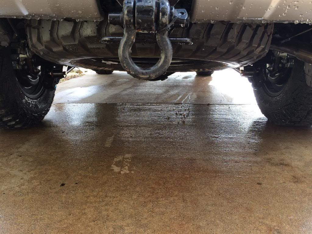

Got a used but pretty treaded spare off Craigslist for $60...not bad
255/80-17 km2

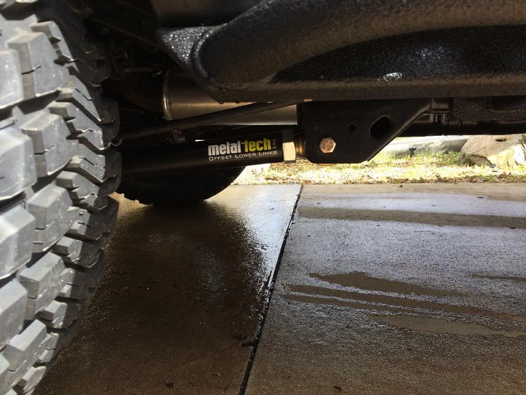

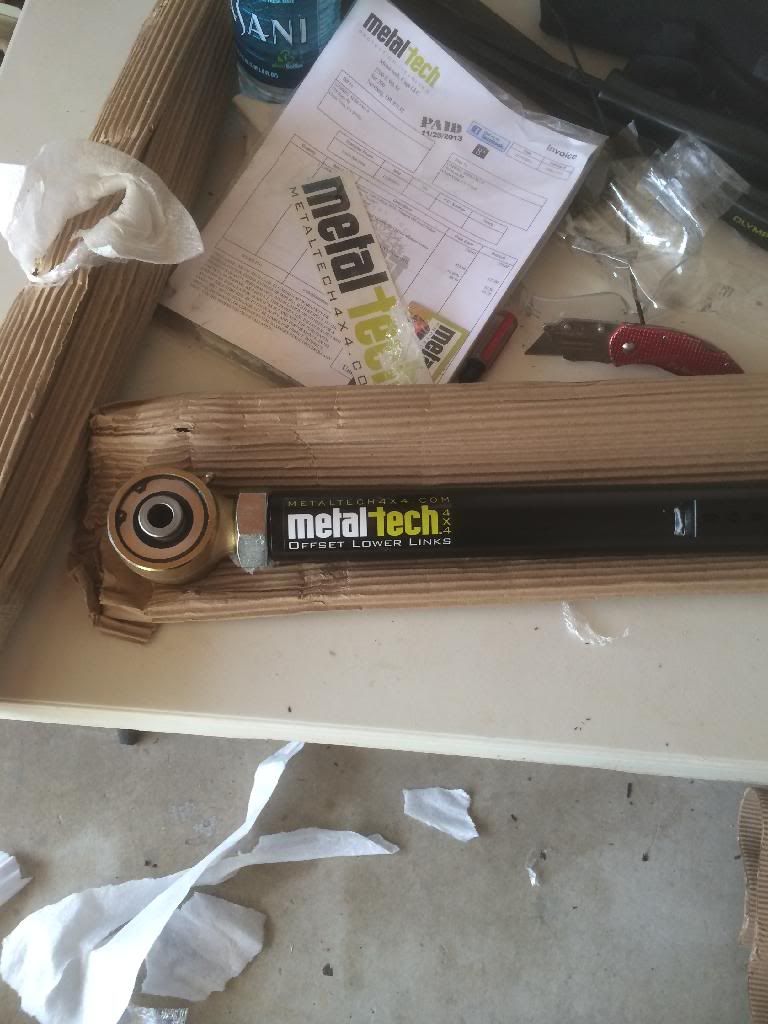

Metaltech LCA's
Ridiculously beefy compared to OEM. I'm impressed with the product, just wish their kit would come with washers for both bolt and nut side. Seems like a no brainer to me but whatever...

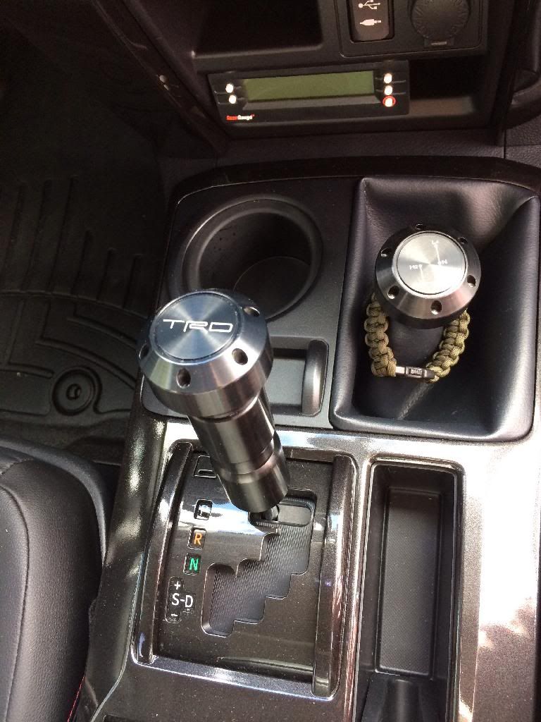

And for those that wanted a better shot of the knobs

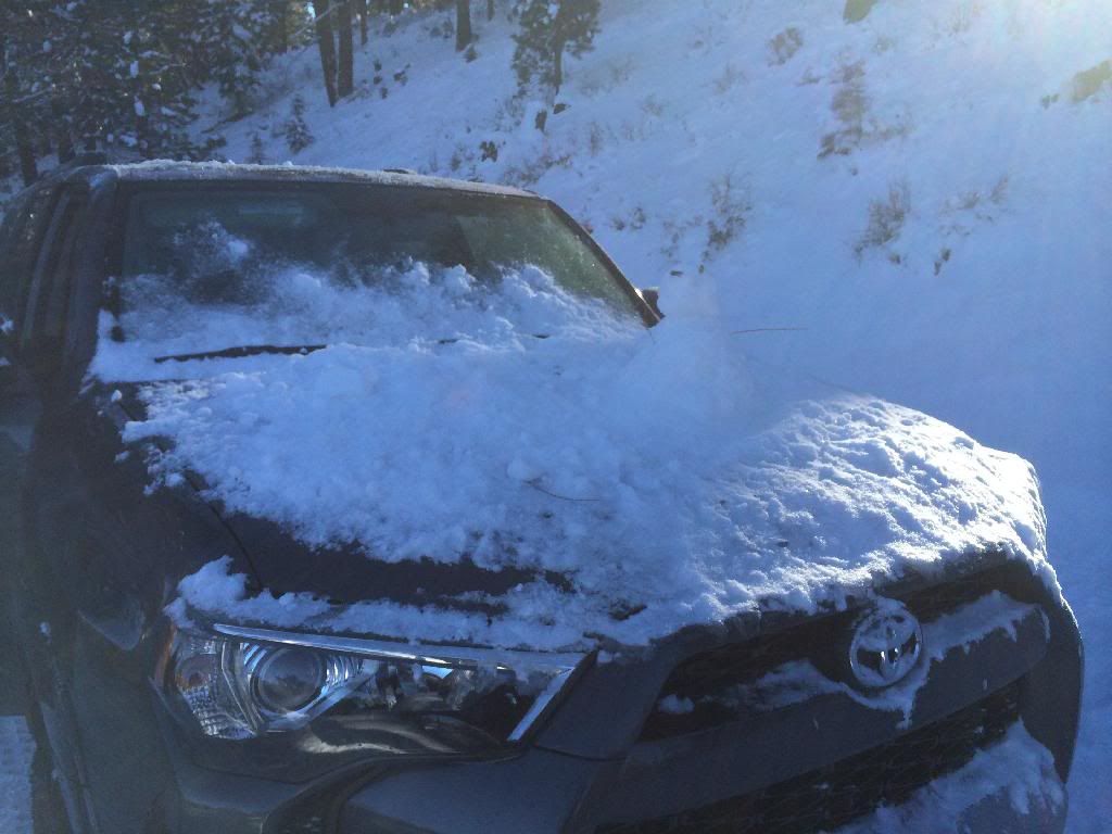

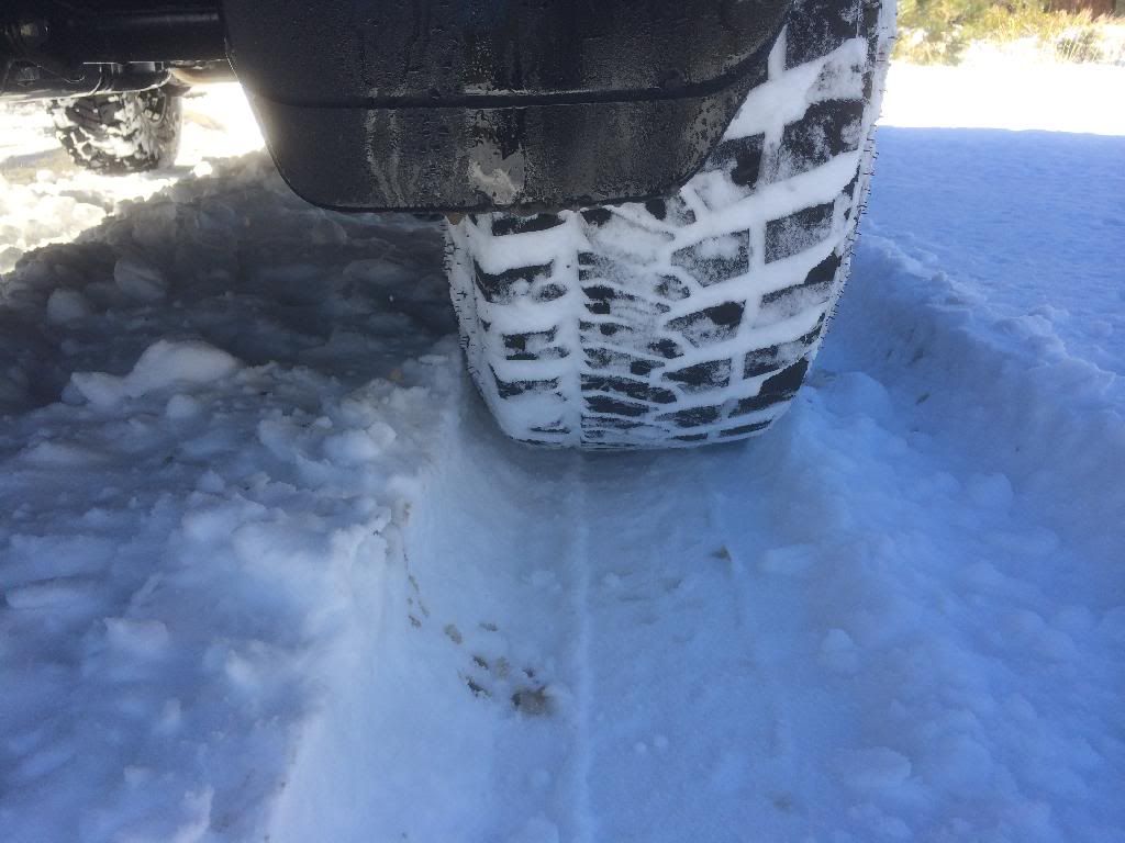

Wife and I escaped to Tahoe for the week.

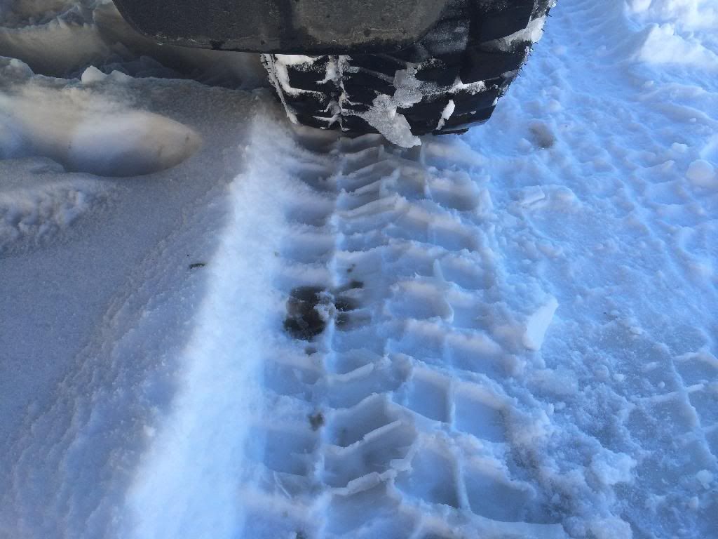

Little winter wheeling
MTR's did pretty good. Although I live in San Diego so I'm not one to gauge how well tires do in snow. I didn't wreck so it was a win!
Obligatory hood snow man

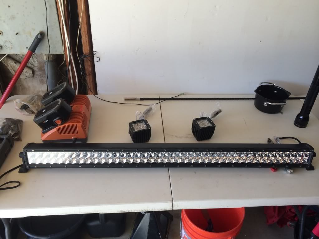

Got a new 10" E2 this afternoon. They changed the bodies over the regular E series and I think it's a great improvement.
New thread holes in the bottom of the body is going to be a fantastic theft deterrent for bumper mounting!

Do you have a air tank mounted that the ARB is filling , or do you just fill directly off the compressor ?
Isn't the duty cycle to low for continuous use when airing tires back up ?
Just curious , I have front and rear ARB's , but my understanding is that the compressor was not best suited for extended use like filling tires directly ... but I have some pretty big tires to fill also :ylsmoke:
marshal
Burrito Enthusiast
if I'm not mistaken the large ARB compressor is rated for continuous use, its the small one that they include with their lockers that isn't.
