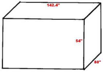

Now some common sense: if it’s really cold out and you’re trying to stay warm in your van you should curtain off the front end. With the windshield, windows, doors, vents, etc it’s a very inefficient space to heat. The same is true of the penthouse top, so close it. Doing those two things leaves us a box that is from floor to ceiling (overall height 82.6” - ground to load floor 28.6”) 54”, and from the rear of the front seats to the rear doors, 142.4” long, and from side to side (ignoring the wheel-wells’ volume, so we’ll use overall width without mirrors) 79.4”. That volume, 54”x142.4”x79.4,” rounded off, is 610,550 cubic inches, or ~350 cubic feet. This is the space we’ll try to calculate the heat needs of. Ford calls it 278.3 ft3. They're probably right, but I want to exaggerate the need to prevent under-sizing the furnace.
Now the floor, at our hypothetical 80”(6.667 ft) x 142.4” (11.667 ft) has an area of 77.78 sq feet, is entirely steel (single-wall), and as steel’s R value is about 0.003 per inch, it’s practically nonexistent as insulation (great conductor though) but it is nice and wind-proof so there’s something. The side walls (54” x 142.4”, 53.4 sq ft each) are likewise steel (and largely single-wall) but also have large openings in them for the passenger-side doors, (48.1” x 44.8”, 14.9 sq ft) and their windows, (19-5/16" x 19-1/8", 2.5 sq ft each) and I also have a sliding window on each side that’s 42” x 15”, 4.375 sq ft. This makes them even worse from an insulation standpoint. The passenger side is 29.125 sq ft of continuous steel plus the doors themselves @ 14.9 sq ft, so 44.025 sq ft of steel (windows already deducted) and the driver’s side is 49.025 sq ft of steel (window deducted). The side glass totals 13.75 sq ft. The rear wall, 30 sq ft, minus the windows, is 25 sq ft of steel and 5 sq of glass. The roof is slightly better when it’s down due to being fiberglass vs steel, R 2.5/in vs .003/in, and has the 4”or so mattress and ½” plywood (maybe 3/4, I dunno) and upholstery serving as insulation. The fiberglass roof itself shares its dimensions with the floor (hypothetically of course) at 77.78 sq ft and about ⅜” thick (.375 x 2.5/in = .94 R), and the bed is 42”×78”, 22.75 sq ft, of mattress foam (4” x 3/in = 12R), upholstery (.125 in x 1.60/in [vinyl] = 0.2R), and plywood (.75in x 1.10/in =.825R). This all adds up to the Penthouse top (when down) having an approximate R value of 13.965.
Assuming the curtain at the front seats is uninsulated but draft-free, and no other insulation is present in the rear of the van, we have a volume of 350 cubic ft and an exterior surface area of 77.78 sq ft penthouse [27%] @ (13.97R) + 195.83 sq ft steel [67%] @ (0.0R) + 18.75 sq ft glass [6%] @ (0.91/in R) = 292.36 sq ft. That ~292 sq ft has an average R value of 3.55.
Let’s say the coldest I want to camp is 30* outside and I want it 65* inside. That’s a difference of 35*, all in fahrenheit. How much heat do I need?
There’s an equation for that:
Heat loss = Q/t= (area)(Temp in - Temp out)
Thermal Resistance
If we’re using units of BTU/hr for Q, sq ft for area, and *F for temperature, Thermal Resistance will be the “R value” unit, convenient, huh?
okay so BTU/hr is what we want to know, (292.36sq ft)(35*)/R3.55= 2,882 BTU/hr heat loss.
So if the van is 65* inside when you park and shut it off, and it’s losing 2,882 BTU/hr, you need to put 2,882 back in (plus a bit for drafts, wind, etc, call it 3,000) just to maintain the 65* you started at. If you started at 30* and want to warm it up to 65* it’ll take about 8,000 BTU to get there at all (because the greater the temp difference, the greater the loss and you’re starting with 30* air inside), and more BTUs output means faster warmup. Forced air is also much faster than radiant due to air movement across the heat exchanger. In reality, if my van was already 30* and I wanted it 65* I’d crank up the engine and it’s heater, and whatever heater I had until it hit 65* then switch off the engine and let the heater maintain. I have a lot more gasoline capacity and it’s a lot easier to replenish than propane.
So let’s say we can add 2” of insulation to the walls and doors, 1” to the floor, and we cover all the windows and get them up from R0.91 to R2. R6.7 Ultratouch is my current pick for walls and doors. R3 rigid foam for the floor, ½ foam between two sheets of ¼” plywood (R 0.55) so the floor is now 77.78 sq ft (27%) of R3.55, the 18.75 sq ft of glass (6%) is R2, the side walls are 93.05 sq ft (32%) of R6.7 [+ .155, see below], the rear wall is 25 sq ft (8%) of R6.7 [+. 155, see below], and the roof remains 77.78 sq ft (27%) of R13.965. Our average R value is now 7.58, an improvement of over 100% (more than twice as insulated).
Heat loss is now (292.36 sq ft)(35*)/7.58R= 1,349.95 BTU/hr, an improvement of over 100% (losing less than half as much in the same time period). So keeping a 65* van with insulation at 65* requires ~1350 BTU/hr and taking it from 30* to 65* needs ~3,500.
