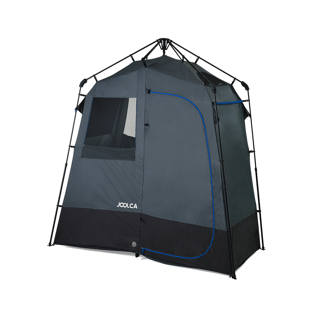

Crux
We setup the Joolca tent next to the truck and feed the shower hose in the side zipper.
We like it because it’s is fully enclosed which is nice when it’s cold or windy out.
Also it has two compartments, so you shower in one and dry off / change in the other.
It packs up and slides between the truck and camper.
Plus their ads are hilarious :)
