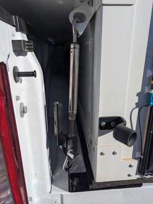

There was a past thread on getting locks to fit into the Derringer handles with the later eyelet alignment, I managed to do it with the anchor upside down, there's juuust enough space for the handle to work at the bottom of the bed:
