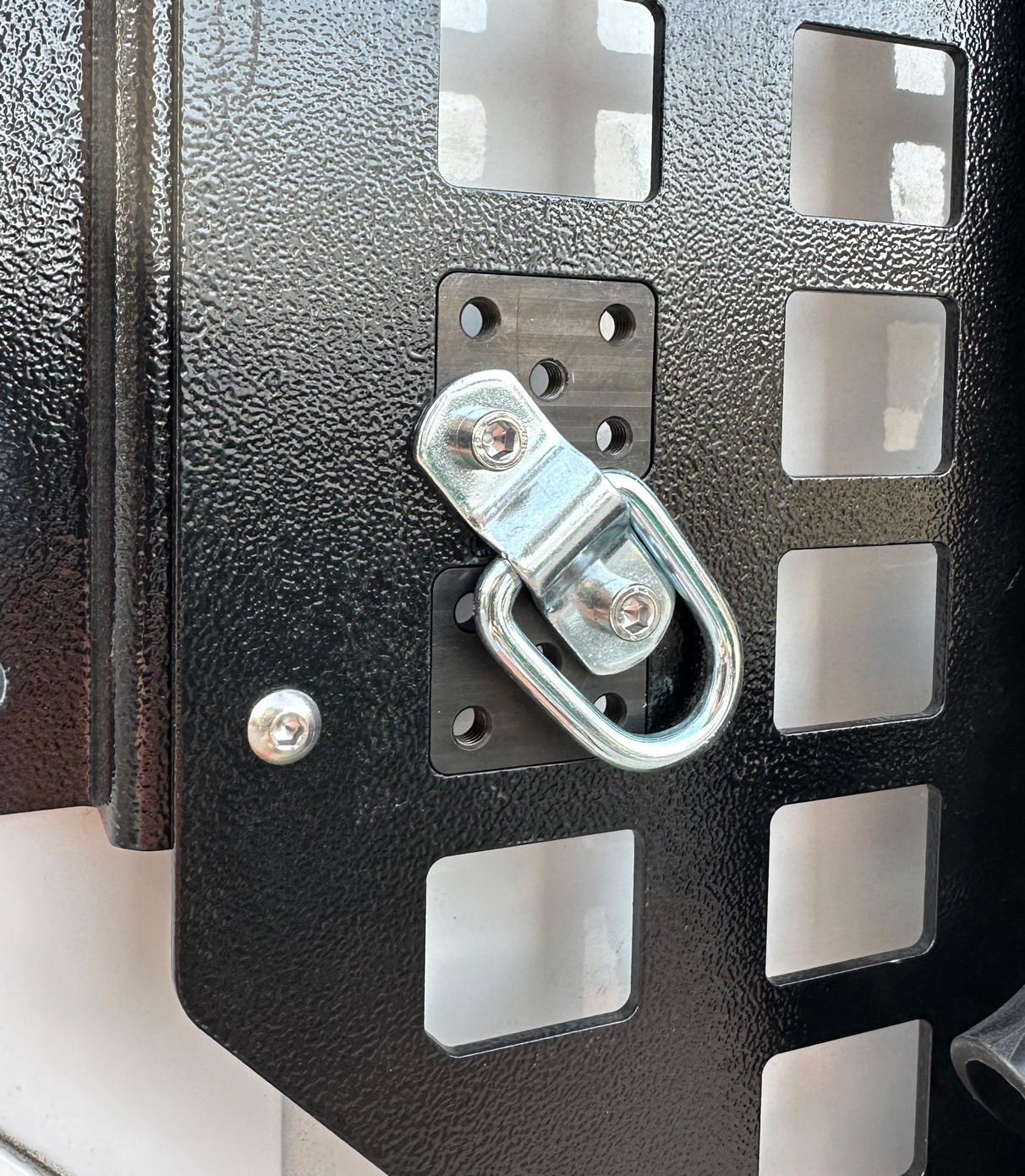

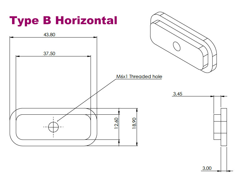

I made another batch of Mollenuts....

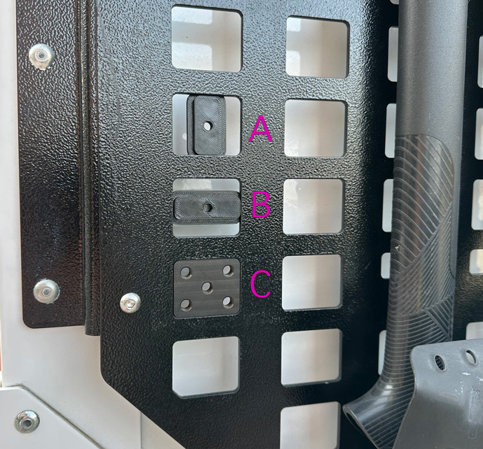

Mollenuts are a convenient way to mount things to your OEV Molle Panels. They're specifically made for the panels on most OEV campers.
There are 3 different form factors for the Mollenuts:
A.) Vertical orientation — $14.00 each
B.) Horizontal orientation — $14.00 each
C.) Full Square — $15.00 each
Why are they so expensive?
  • They're made from 303 Stainless Steel with Black Oxide coating to resist corrosion
  • I can only afford to make about 100 pieces per production run
  • I'm not a company, just a dude who needed these for my OEV Molle Panels
  • Because somebody put tariffs on stuff
  • I can't find someone in the USA who will make them cheaper or take my order
How do I use them?

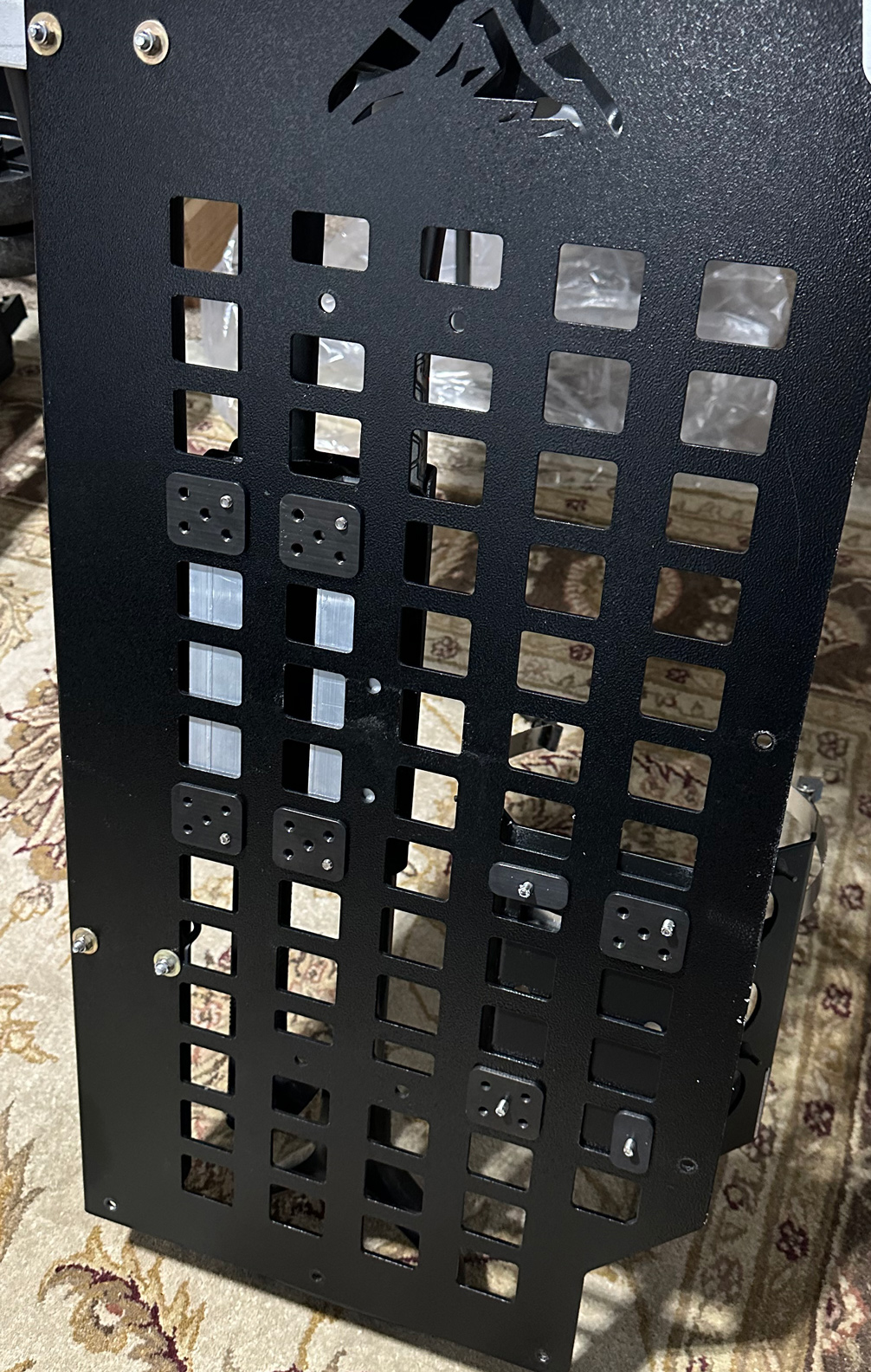

Here's a picture showing the back of my left side Molle Panel. I used them to mount my Axe/Shovel mount and Propane Tank mount. Notice that I used all three types to get things to fit:
In this picture, I'm using 4 pieces of type "C" to mount the Pelican case that holds my Starlink:
L Bracket mounted on the front:
Tie down ring mounted on the front:

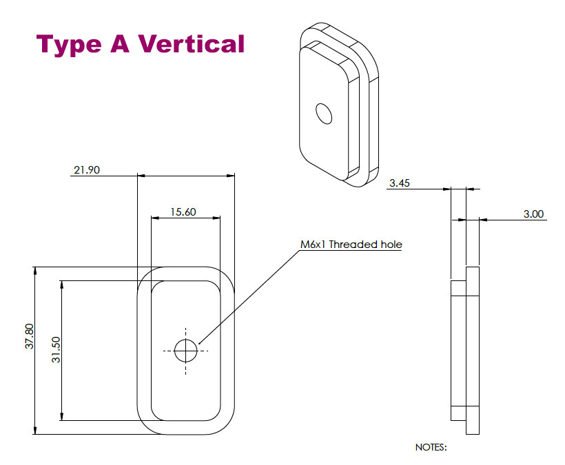

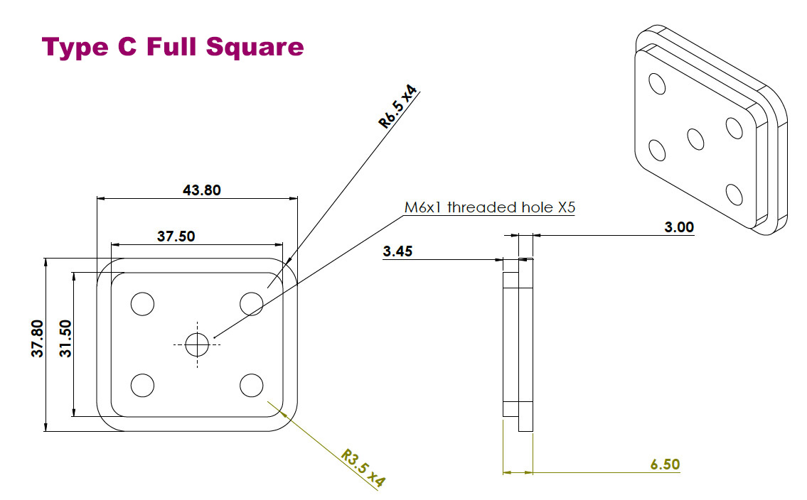

Technical Details
These are the drawings showing the dimensions of each type of Mollenut:
Vertical:
Horizontal:
Full Square:
Ordering
I'm not a storefront — just a guy doing small-batch production runs and shipping them out in a USPS flat rate box.
Flat shipping fee: $10.50 per order (up to 100 units)
Order or learn more:
https://www.contactdi.com/mollenuts
If you have questions, there's a contact form at the bottom of the page.
