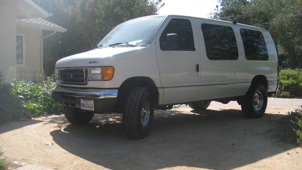

Last year I sold my Jeep because it was getting too hard to get into and moved up to a van. I thought I'd be cool to share some pictures. With a bed in the back, I figure it'll be great for overlanding.
I just put some bigger tires on it - 285/75/16 - so hopefully I can drive on the beaches in Mexico. It's not 4wd yet, but one day it will be.
The wheelchair conversion added a 2" body lift to make room for the 6" lowered floor. Then a Vangater lift was installed. The nice thing about the Vangater is that it folds up when in the stowed position.
The seats are on pedestals and can easily be removed if I want to drive from my powerchair.
I added an auxiliary battery under the back seat with a Hellroaring Battery Isolator/Combiner to power a 12v cooler and my respirator at night. It really comes in handy for jump starting myself because the lift draws a lot of power and the main battery often goes dead.
Also made a kitchen box that mounts on the back next to the spare tire to carry my stove and dishes.
Next step is to put a winch on the front and install a ham radio....

Looks good with the 285's. How does it ride with the body lift?
And do you know what the floor to ground distance is ?
I'm looking at a lift like that as well. I love the fact that there isn't a second post right behind the pass seat, limiting the ability to recline the seat.

@Birdman - No complaints on the body lift. Looks much better. Still had to cut the wheel well and fold the body back to make the tires fit. The floor to ground height with the lowered floor and 285 tires is 25". The base of the lift is 4" above the floor so the available travel is maxed out 29". See picture below. Are you going to put in a lowered floor? If you do tell them not to extend the floor into the driver side wheel well. It'll get in the way of the bigger tires.
If I do a 4" suspension lift I think I can get about 2" extra travel because the angle of the platform goes down a bit and then I can make up for for the rest by blocking up the bottom.

Floor to ground clearance is the big hassle when it comes to lift.
I really like the lift you are using and just wish it was possible to get a longer arm setup or something.
Great build and keep us posted

Nice setup - I'm wondering how much easier engine & drivetrain maintenance would be with a 2" body lift, being able to have more room around everything under the hood & chassis?
