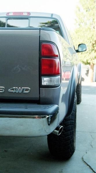

Yeah, post your pics. A view of the side fender clearance would be good also. I wanted to put some bushwackers on, but they don't make them for the older DC model, so I want to keep the wheels/tires tucked if possible.
I have 00 tundra AC, if you want pics of 285's I can post up. I know it's not the same model. So let me know. However, I would suggest the 285's over the 255's.
i also have a pic of when i had no lift and was running 265/75/16 AT's.
Running 285's on stock toyota alloy wheels is not recommended but, it's possible. I had a friend who ran 285's on his stock alloys for his taco. Dimensions are definitely different and as haggis stated, you'll run into contact issues with the tundra.
dyogim
These pics were taken back in 00-03.
Stock height with 265/75-16 goodyear AT's.
2.5" lift front, 1.5" rear, bushwacker extendo flares, 285/75-16 goodyear MTR's mounted on 16x8 4 5/8" BS IVan Stewart wheels:
