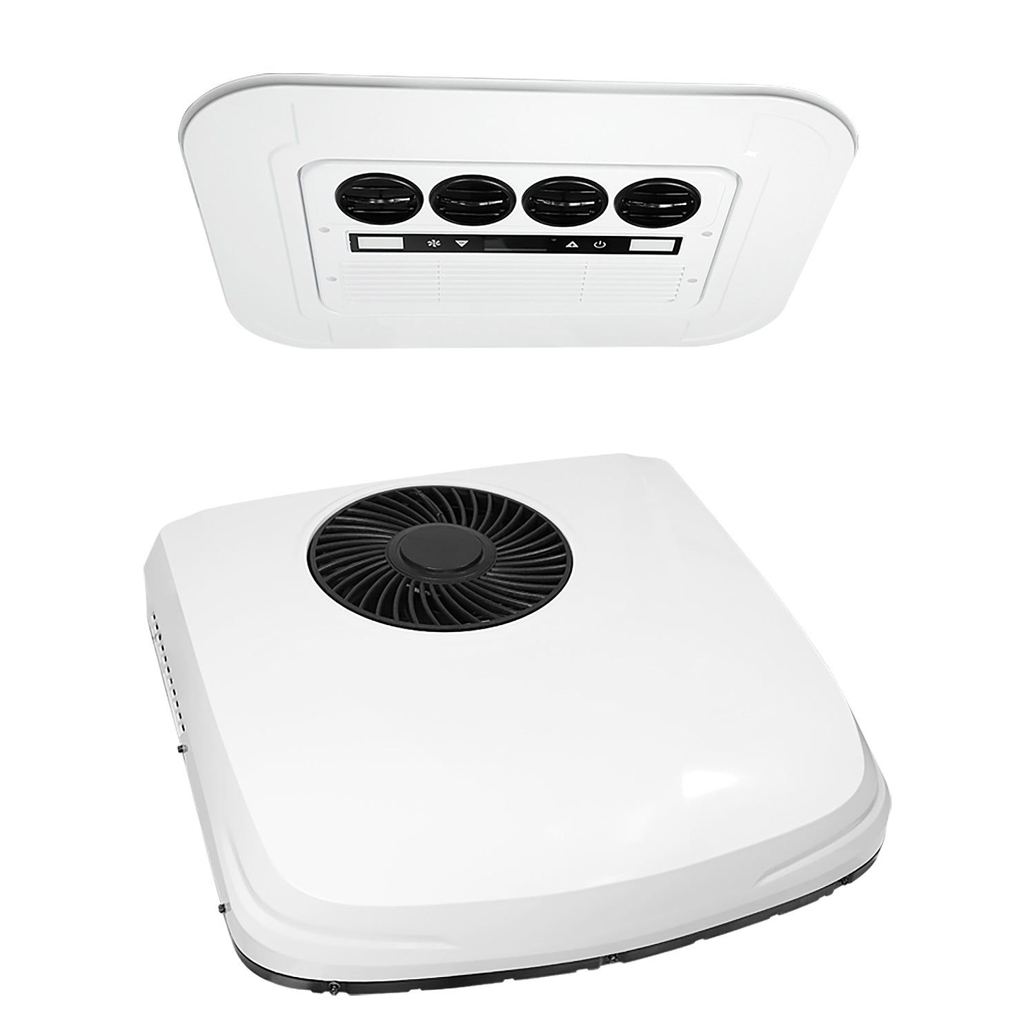

Looking at adding one of these 12 Volt OutEquipPro Rooftop A/C units to our Tiger Camper and curious if anyone has one and the pros/cons of it?

Can you translate in easy to understand terms for us less 12v power literate folks how much solar power you would need to run this unit as well as the rest of your rig (compressor fridge, water pump, and a few lights, etc)?

I haven't dealt with that exact one. But I did put a Velit on the top of my kids camper trailer, https://forum.expeditionportal.com/...1102-trailer-build.235492/page-6#post-3177942 , and it looks to be exactly the same or very similar. Its been great so far, and uses very little energy. With a 300ah battery, it doesn't use but 120ah or less at night, around 10hrs of use. Then with only 700 watts of solar it charges it up, and its always at 100% before night fall. I'd buy again in a heartbeat.

Did you have to run bigger wires up to it?
Use the amps way down at the bottom of the ad to determine how long you can run the compressor:​
  • ELECTRIAL​
    Rated voltage
    DC 12V / 24V
    Current range
    21-58A / 15-35A
    Standby power
    1W
    Soft start function
    yes
    Pre-installed inline fuse
    100A / 80A
    Power cord specification
    6AWG / 8AWG
    Note: Most starter batteries can’t handle the continuous 58A (@12V) draw in Turbo mode. Use a LiFePO₄ battery with a 100A+ BMS or a 1000W+ AC-to-DC converter connected to your power station’s AC output for stable voltage and reliable, worry-free comfort.

That's a cool little unit. It's an inverter driven scroll unit. Should sip power and it looks like less than half of my RTU now. It's also 6 inches less tall than mine. I'll be watching.
Got my eye on this too, plan on running it in a wedge camper with 500w of solar next to it and 630ah of battery in the house
