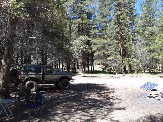

Also agreed, don't be so quick to discount solar... especially if you keep your panel(s) portable. A portable setup allows you to place the panel away from the trees and aim it directly at the sun for maximum power harvest.
The loads you mention are fairly light, 100-150Ah of battery capacity + 100-150W solar setup I would think should be able to maintain that no problem (if you add a 12V fridge, then bump it up to 200-300Ah + 170-250W solar).

Maintaining it purely by solar I don't think is out of the question though... two 100W panels set up as portable should still keep up with it no problem.
My setup:
I run two 12V Delco Voyager deep-cycle batts in parallel (190Ah total, I recall), solar is 170W. The panel folds up like an oversized briefcase (I put hinges + a carry handle onto two 85W panels) and straps down to the roof of the vehicle while underway. Easily keeps up with a fridge, playing the stereo all day (low-medium volume) + a few hours use of 10-20 watts of LED lighting at night.
