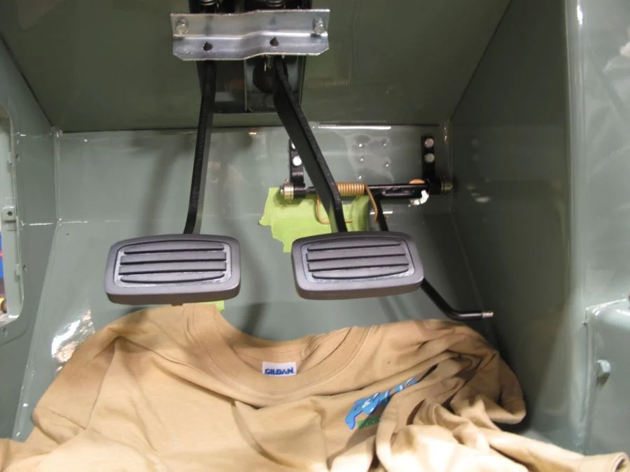

reproduction pedal pads
pedal-assembly1-jpg.1163156

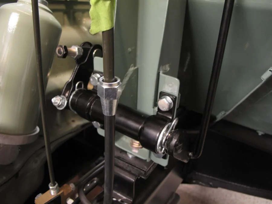

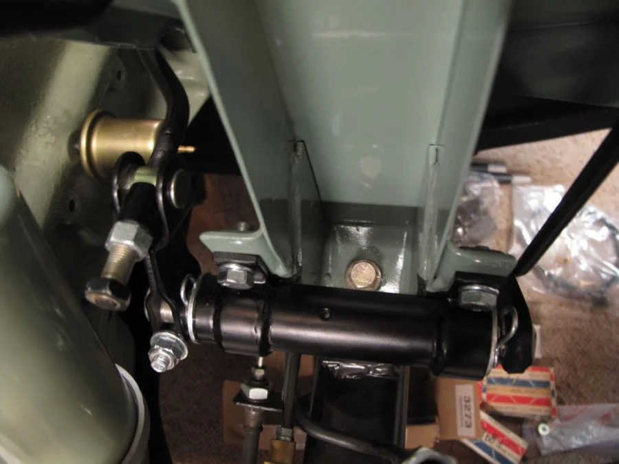

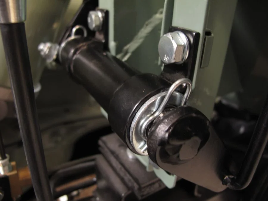

clutch linkage/pivot point all restored, these trucks up to 1968 used manual clutch linkage, not hydraulic. New fuel line in the foreground, the compression nut is original and was plated then installed on the new line.
clutch-linkage-jpg.1163157
clutch-linkage1-jpg.1163158
everything is original down to the mounting bolts, although I did have new brass/bronze bushings made up for all the pivot points on the entire truck.
clutch-linkage4-jpg.1163159

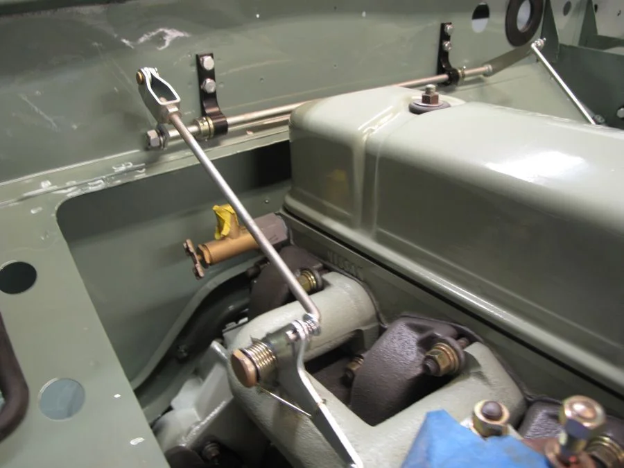

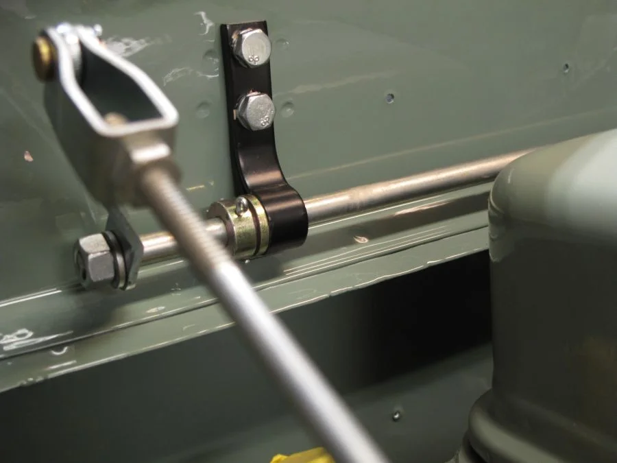

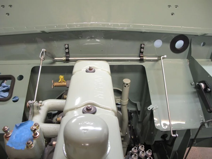

throttle linkage completely restored, only non-original parts are the cotter pins!
throttle-linkage1-jpg.1163161
throttle-linkage2-jpg.1163164
Notice the "dp" on the bolt heads. Pretty much every bolt on these trucks has this on it, which is why we decided to restore it all and use over replacing with new hardware. Everything has been plated, even items that got painted. Nissan did this on these trucks so we are replicating that, plus then you won't get rust bleed in the future.
throttle-linkage3-jpg.1163165

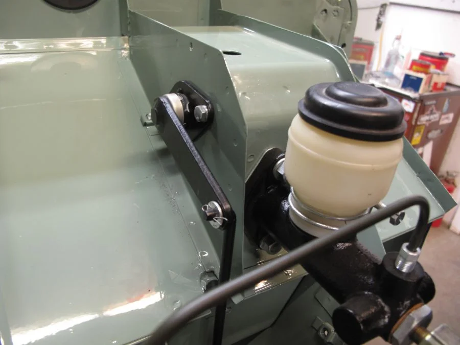

Clutch linkage and master cylinder. Bowl on the MC cracked during assembly, super old and dry. Got a couple replacements in hand.

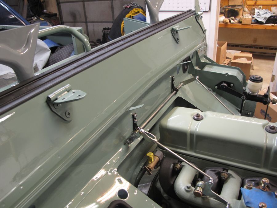

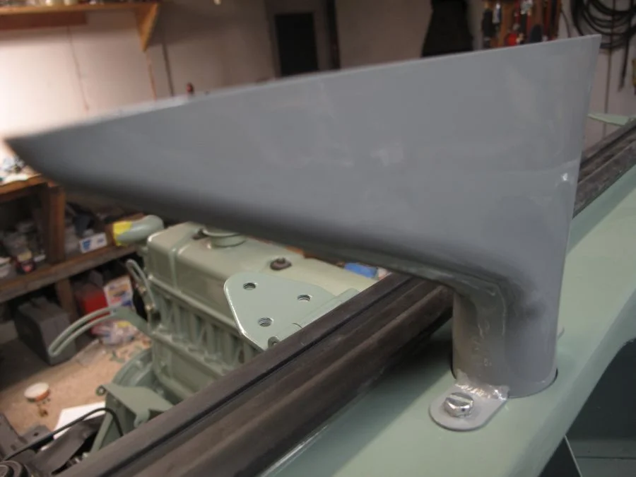

Obviously this is the cowl, the rubber gasket under the windshield hinge is reproduction, the one under the hood hinge I made. Some of the hardware on these trucks Nissan painted, some they did not. It is all about how they were assembled at the factory, replicating that in the resto has proven challenging. We didn't paint this body on a jig mostly assembled as Nissan would have.
cowl-jpg.1163169
Nissan would have painted the truck with the hood hinge on the cowl. We didn't do this so got to be real careful not to scratch/chip up the mounting bolts when assembling. Before anything was painted or even primed the entire body I sealed up every single seam with Rust Bullet, a rust encapsulating paint. After this seam sealer was used on every seam.
cowl1-jpg.1163170
Reproduction on the weather seal that is from cowl to the not yet installed windshield frame. The rubber simply does not exist for these trucks. I am using a combination of reproduction, original that is restored and small items like rubber bumps or grommets is being sourced from Metro Molded and Steel Rubber. I was able to get a Datsun guy to reproduce a few dozen items for these trucks. He has stopped producing it though so what we got is all we got in new reproduction form.
cowl3-jpg.1163174

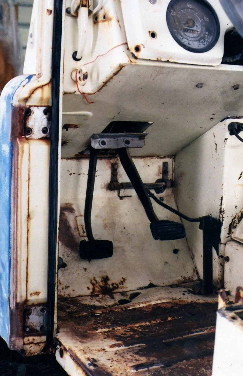

Oh ya and I just came across this picture, unrestored footwell on the 64. :)
pedal-assembly-jpg.1163462

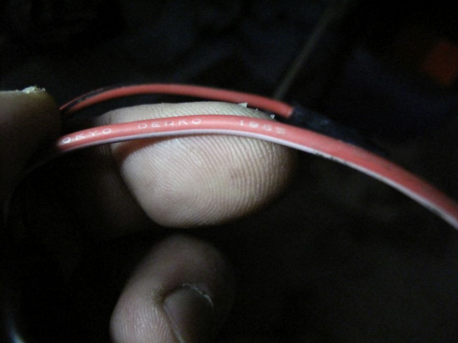

I always really like this about Patrols, main wires in the harness are dated. Pretty friggin' cool! And yes, Yazaki is the company that manufactured these wiring harnesses for Nissan.
image.php

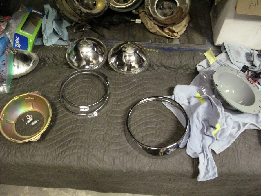

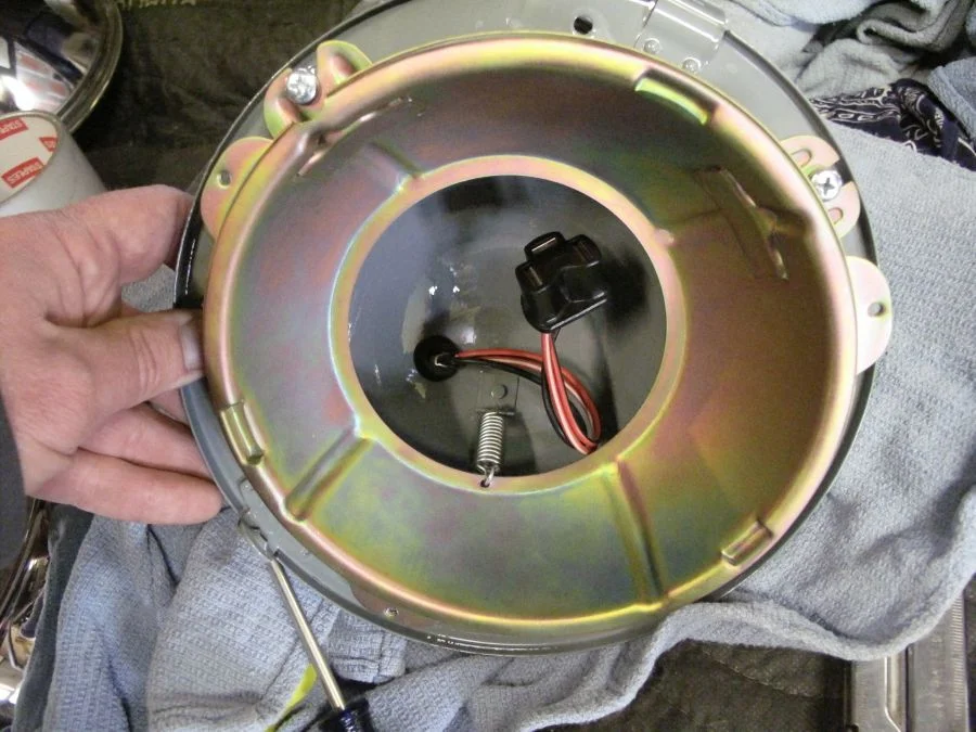

Head light resto/assembly, luckily I have correct pre-68 Patrol Toshiba headlights. As you can imagine, not many sets of these original Toshiba headlights out there that still work. Starting in 1968, they are Koito's.
head-lights6-jpg.1194119
head-lights5-jpg.1194120
head-lights7-jpg.1194121

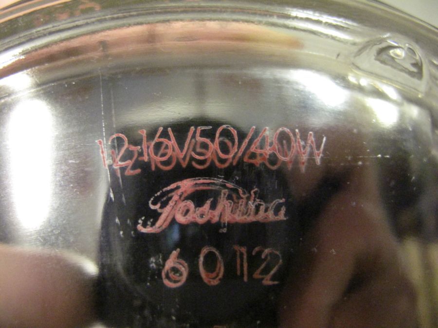

Head light pig tail, Koito and Denko. In case you can't read it, it says "Tokyo Denko 1963"
head-lights10-jpg.1194122
head-lights9-jpg.1194125

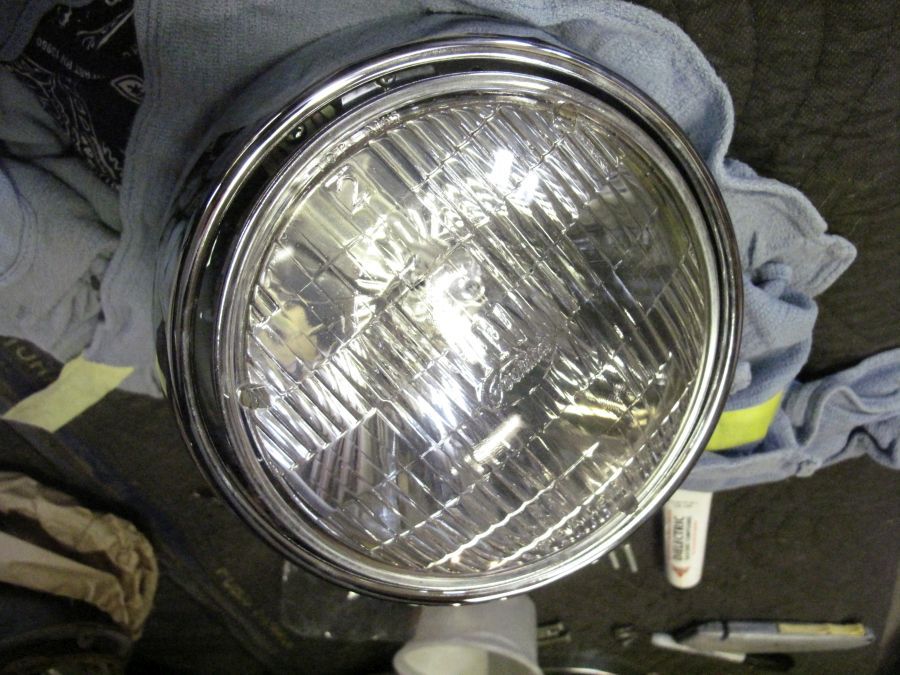

Assembled head light ready to install, with working original nearly 55yr old sealed beam bulbs!
head-lights2-jpg.1194126

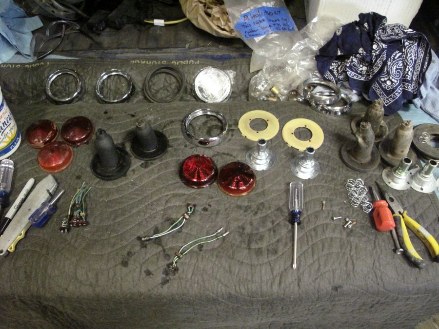

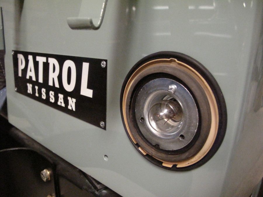

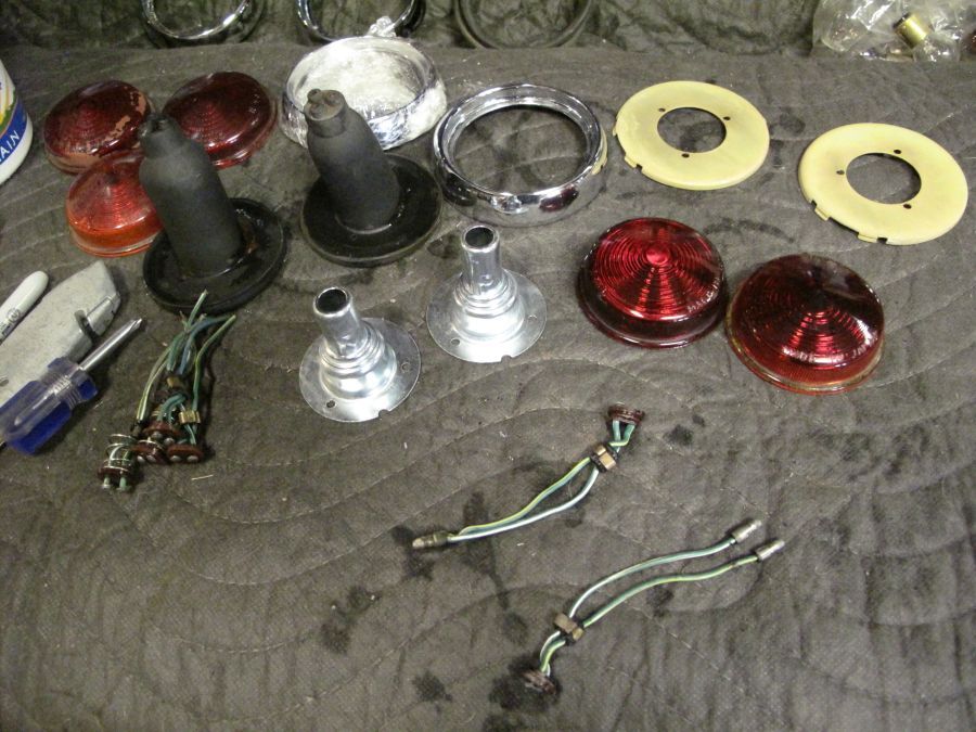

Now for the tail lights, these are a real ***** to restore, mostly because the lens is glass and extremely hard to come by but also because the rubber boots are NLA and needed as they retain the glass lens.
A combo of restored pieces and cleaned up original pieces
tail-light8-jpg.1194127
pick the best parts and use them
tail-light6-jpg.1194128
Fitted to the truck, just need some more mounting screws before installing the glass lens and chrome ring. These are basically unobtainium, people would kill for these!
tail-light5-jpg.1194130
