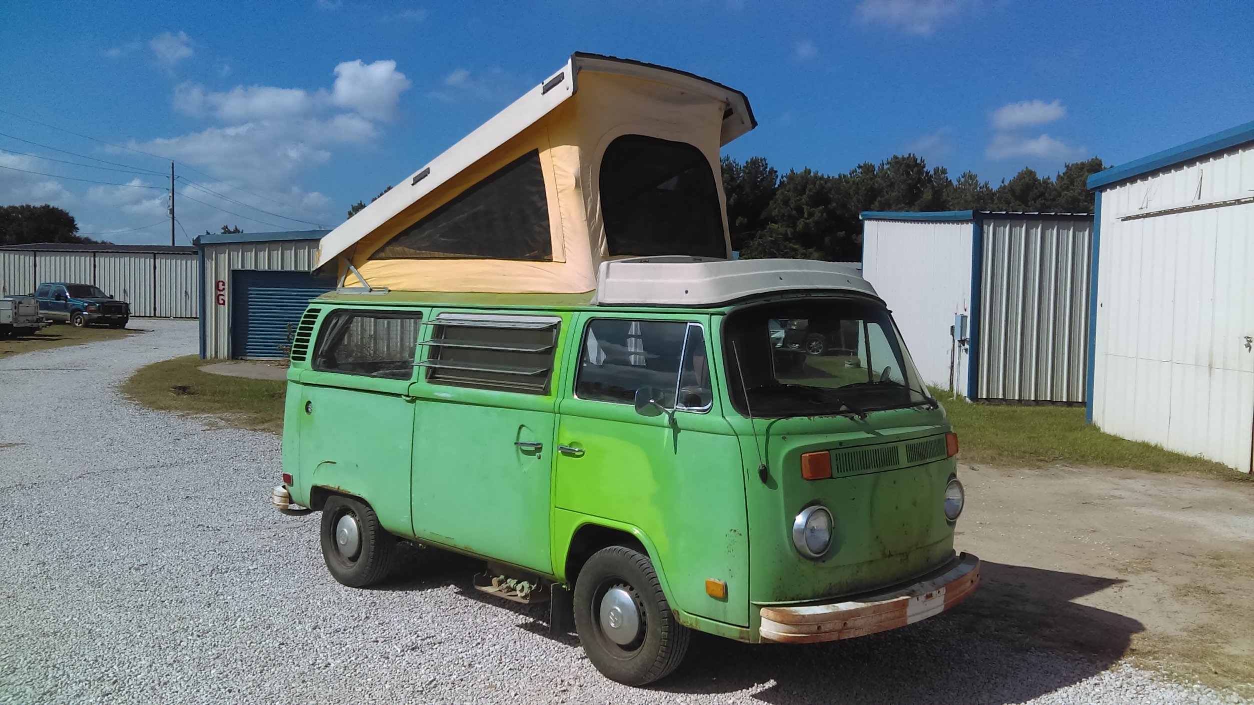

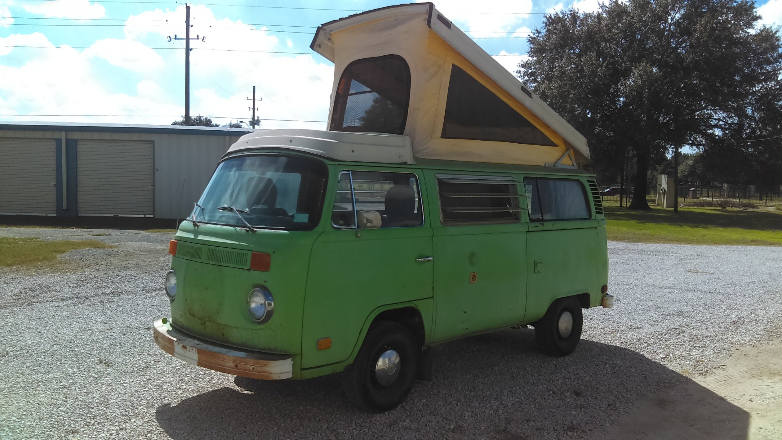

Selling a 1976 Westfalia. His name is Kermit. This is a good clean Bus I got in Colorado, now in Houston, Texas. I just finished rebuilding the engine with all of the best quality new and NOS VW parts. Does not leak one drop of oil! If you know about VW Buses, these late Baywindow Westfalias are the best combo that VW ever produced for aircooled Buses. The powerful 2.0L motor with fuel injection is a wonderful engine to have and far surpasses their previous Buses. These late Westfalias will cruise at highway speeds comfortably, and climb mountain passes with ease as the fuel injection automatically adjusts itself. As well, the bed in the pop-top is actually useable for a full size adult, instead of the previous version that just had a cot up there. These are truly wonderful campers!!

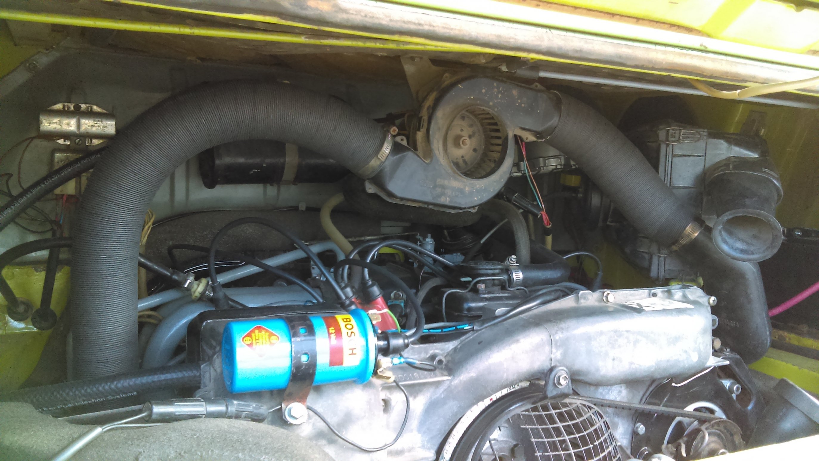

Engine rebuild included the following:
Replaced engine case with a GE code case
Drilled, tapped, and plugged flywheel side oil passages
OE VW crankshaft Std mains/.010" rods
NOS VW main bearings (std/std)
Kolbenschmidt rod bearings .010"
Silverline cam bearings (thrust bearing fit to camshaft)
CB Performance Stock Hydraulic Camshaft
CB Performance Aluminum Cam Gear
CB Performance Type 4 26mm Maxi-1 Pump (spec'd out)
CB Performance Hydraulic Lifters (OEM)
NOS Connecting Rods
AA 94mm pistons and cylinders
AMC Cylinder heads (square port)
Cleaned and lubricated hydraulic rocker assemblies (valves adjusted 1 turn in)
Cleaned and painted VW valve covers (with new gaskets)
Cleaned pushrod tubes with new o-rings
Elring fan hub seal
Victor Reinz flywheel main seal
Sachs 228mm clutch kit with throw out bearing
Great condition original VW flywheel
Rebuilt Bosch Alternator (very hard to find)
Fixed alternator wiring harness
Rebuilt AFM and ECU (Fuel Injection Corp)
Early Vanagon throttle body
Original, good condition, 1978 style F.I. Harness
New throttle body seal, AAR elbow, and brake booster/decel valve Y
New crankcase breather to S-boot hose
New hose from AAR elbow to S-boot
Original "blue top" fuel injectors, new fuel injector o-rings (big and little)
Cleaned and painted intake runners
New intake runner phenolic spacers and boots going to plenum
New air filter (Mahle)
Cleaned and RTV'd S-boot
All engine tin degreased and painted (complete set of tin)
Painted heater boxes
New Dansk left side heater box
New reproduction left side stove pipe from heater box to heater valve
Replacement muffler and tail pipe (Leistritz W. Germany)
New exhaust to heater box gaskets
All fuel line replaced, including lines from fuel rail to injectors
Has the metal lines from each fuel rail to the cold start valve
New oil strainer and gaskets
Taco plate o-ring
Original VW oil cooler cleaned inside and out, new seals
Oil cooler flap "locked down" (no thermostat or 1/2 side flap)
Replaced vacuum lines
Bosch SVDA distributor with new Bosch points and new Bosch condensor (made in Germany)
New Bosch blue coil
New Bosch spark plugs and new spark plug wires
Replacement engine bay foam seal
New alternator belt
Original metal timing scale and original plastic fan guard
Degreased fan shroud
Replacement fan assembly
New heater tubes and fixed heater booster relay harness
EGR blocked off on the engine tin side
New Bosch cylinder head temp sender
Good used thermo time switch, AAR, cold start valve, fuel pressure regulator, and decel valve
Bosch oil filter and Rotella 15w40 oil
Good condition mustache bar rubber mounts
New Duralast battery and battery cables

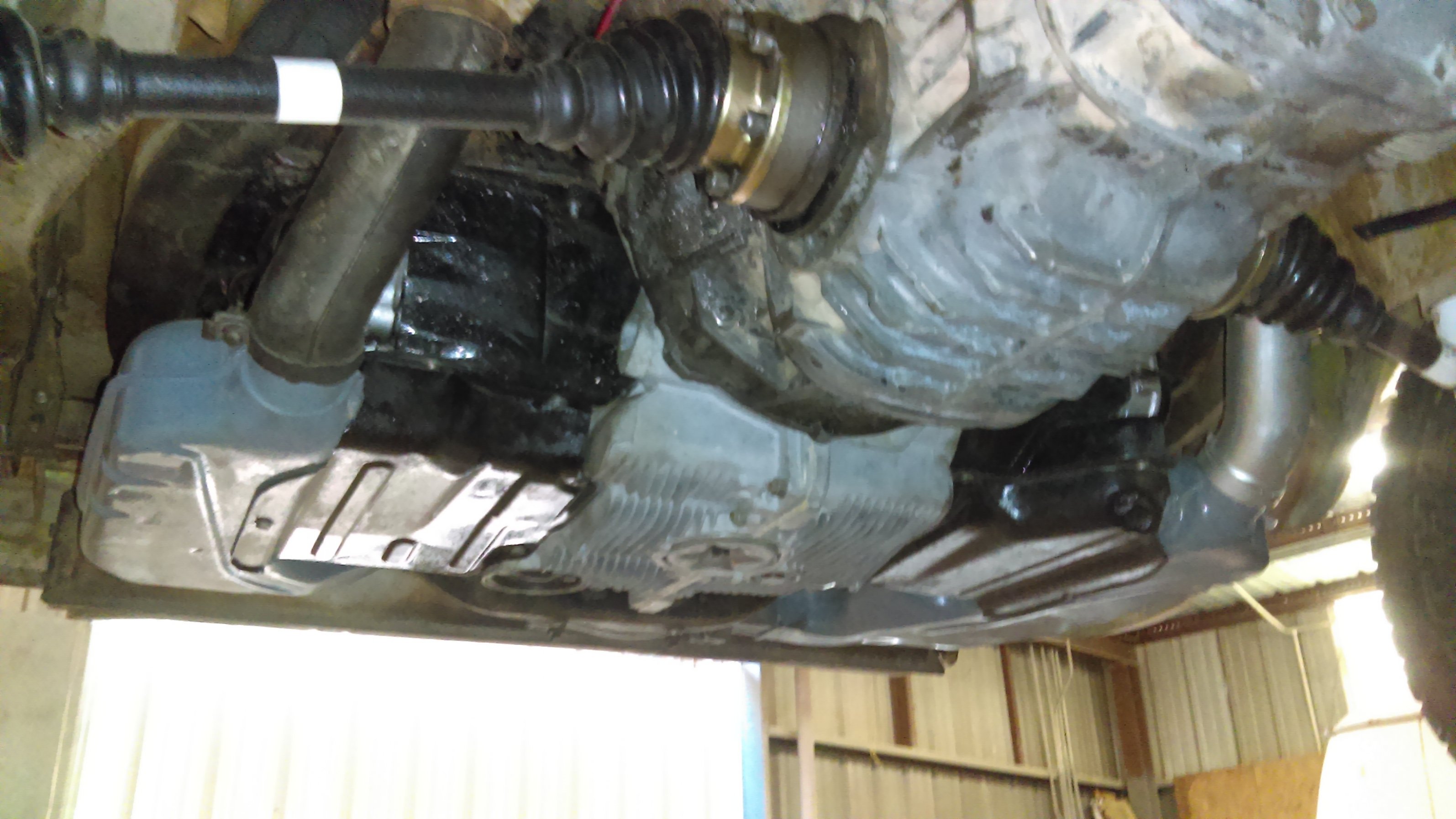

As well as rebuilding the engine, I have also done the following work:
Replaced all shift rod bushings (Wolfsburg West brand)
New shift rod tube rubber boots
Cleaned and painted front and rear shift rod
Degreased underside of transmission
New transmission gear oil (80w90)
Remanufactured in USA original German CV axles (packed with grease and installed with load spreaders, lock washers, and correct bolts)
New front brake pads
Bled all 4 corners with DOT3 brake fluid

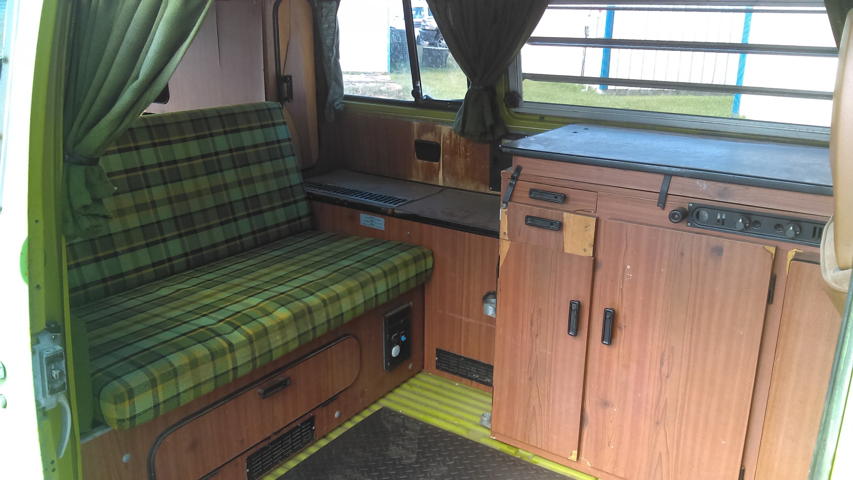

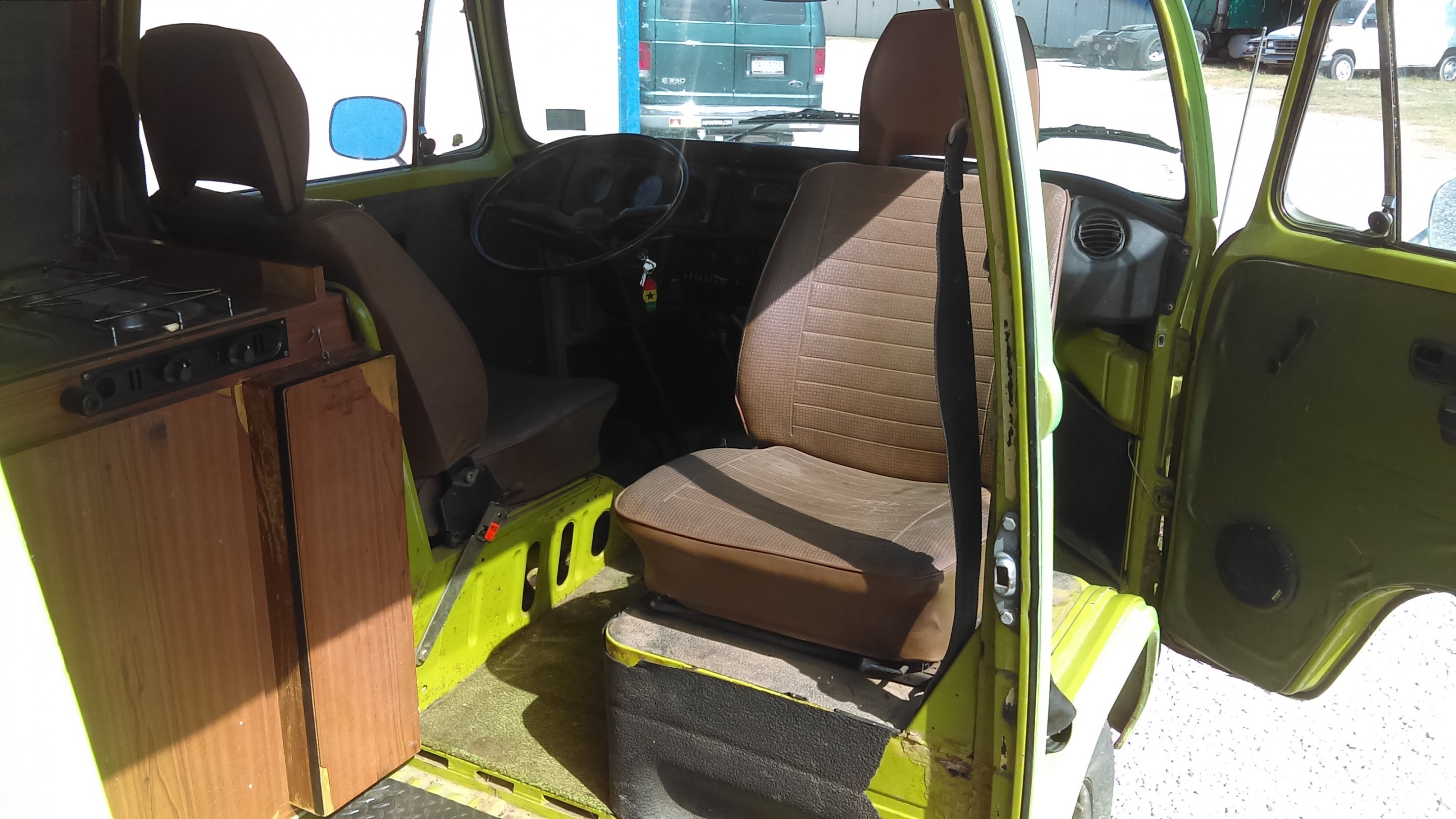

Removed interior, cleaned, and reinstalled interior
