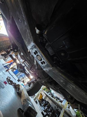

The 5-link is basically finished, I had to cut a hole through the frame and sleeve it for bolt access.

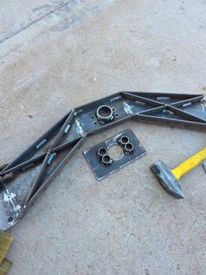

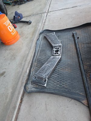

Finally getting around to finalizing my transmission crossmember, made a rough template last night. I'll probably make a hand made part first and then a machine made part later, all of this rear axle swap has been hand made so far because I doubt anyone would ever go JL axles but I could totally see someone wanting to UZ swap their Gen 1 in the future so it'd be good to have a part file.

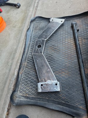

Finished up the crossmember today, ground down and ready to paint. Nevermind my gouging, all I had was a 24 grit disc and nobody will ever really look at this again anyway. Fits really good and the bolts are all recessed in case I get nutty.

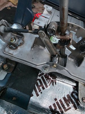

The more I looked at the 4 Runner shifter in the Montero the more I hated it, I started looking into other options. Originally I thought the Montero shifter was going to be too much work to make it shift the A750 and It would be clunky. I looked into a few aftermarket shifters and then took apart a couple Gen 1 and 2 shifters, the Gen 1 shifter is the style I want but there is no way I can fit a linkage shifter under the body now. The Gen 2 cable shifter will work but the challenge there Is that the throw ratio doesn't match the new transmission. I learned the Gen 1 shifter itself will physically install on the Gen 2 cable shifter, this got me motivated to make it work because It will look like it belongs aside from the height.
I cut apart the Gen 2 shifter and shortened the throw of the shift arm to match the ratio of the transmission, this is important because the detents on the in cab shifter need to match the positions in the valve body otherwise ranges won't work or there will be hydraulic bypassing. I also moved the cable position to dead center because that's where the shifter mounts on the Gen 1, hopefully this will allow me to modify a stock center console to cover this mess.
All cleaned and cut apart *did not take a before photo*, I had already measured how much the arm needed to be shortened (9/16").
Refit the cable mount to test the operation and detent matching.
Somehow I managed a first time perfect fit and throw!
Super stoked on this fit up, also forgot to take pictures of the floor mounting bracket. I am aware that the center console mounts to the same holes the mounting bracket is bolted to. I'll try just using longer stock panel screws but I'm prepared to do nutzerts and stainless screws for a clean finish.

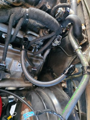

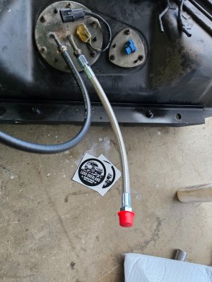

Converted my high pressure fuel line to -6 AN.
Braided line from Luso at the tank side with all new rubber hose, he had a new filler for me as well.

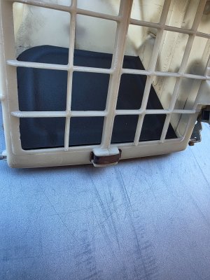

Cleaned and resealed my blend door with fresh foams.
Fresh foam at the connection
...and at the outside air hole.
In doing this I found two things, the first being that my blend door doesn't work, the plastic holding the cable is broken so the cable doesn't pull. The other is that the blower motor is shot, the brushes were wasted and the commutator is all chewed up. So those need to be replaced.
