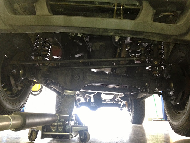

A shot I took of the undercarriage before removing the stock steering linkage and relocating the steering damper (sorry, forgot to take an "after" photo):
